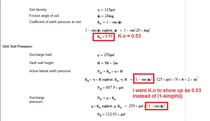

Please see attached.
I want to show intermediate steps in my calculations, but when using the explicit function, the value I refer to shows up as the original symbolic value instead of the calculated value. This is a little confusing to explain, so please see the attached picture. Does anyone know of a good way to fix this?
Thank You!
April 10, 2013
Try evaluating K.o inline. That is evaluate K.o along with its definition.
K.o := 1-sin(phi) =
