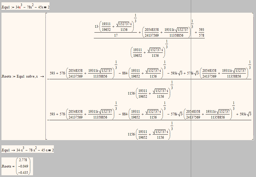

I have a question about formatting the results of an equation. Is it possible to either simplify or straight out hide the intermediate step that is shown in the attachment. I really am only interested in the final decimal answer.

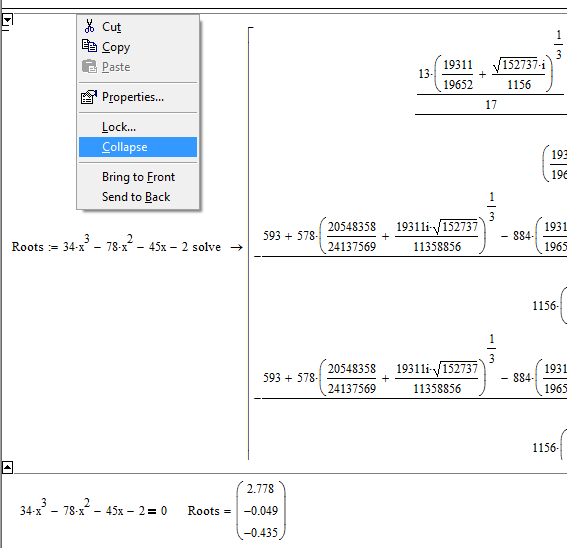

I do so in this case:
November 30, 2012
Thanks for the suggestions.
Norm, I need to actually solve for DBT and get a value so evaluating doesn't work for me here.
Valery, your suggestion technically works but the values outside of the collapsed area are no longer "live" and must be updated accordingly if the original equation were to ever change, correct? It is a better solution than nothing but I had thought MathCad would have a good way of just hiding that expanded solution.

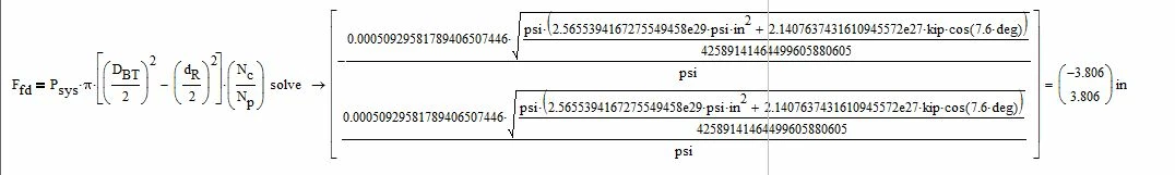

It sems that you just need to use the modifier "float" with the symbolic solve:
You probably won't need the last numeric evaluation anyway.
With Valery's approach you could assign the equation to a variable for easier editing and automatic display.
If you mind the error message from the numeric processor 'cause x is not defined, you could use "Equ1(x)" instead of "Equ1".
November 30, 2012
Werner,
I had tried the float modifier earlier but was not getting the syntax correct. I just tried it again and got it right so I believe that is the best way to do it although my particular equation still barely fits on the page.
I find it strange that MathCad gives you the ability to "Hide left-hand side" but not hide the unsimplified solution.
