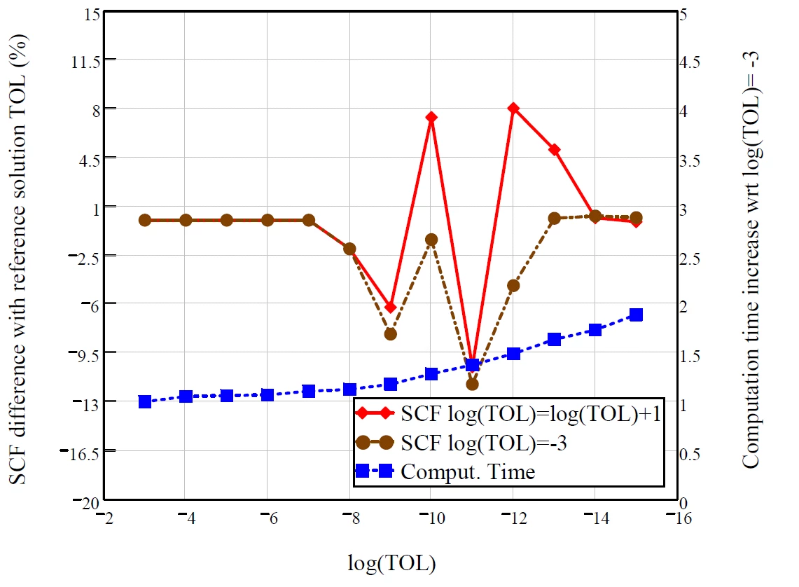

Hi everyone,
This is a question involving the functioning of the numerical integration operator in MathCAD 13.
In my worksheet I am solving a complex problem which involves numerical integration of multiple periodic functions.
While testing the solution, I am varying the parameter TOL between 10^-3 and 10^-15 to see which influence it has on the results. Now, one would think that, as TOL decreases, the solution should go to some sort of convergent point. But, as one can see in the attachment, the solution first is convergent, than starts to deviate and seems to go to a convergent solution again.
My suspision is that this is due to the internal integration algorithm of MathCAD13. Has anyone already seen this behaviour? Is it normal and can it be avoided?

Interesting, never thought about that behaviour. Without the sheet we cannot test what the effect would be in newer versions of Mathcad, though.
There is a quicksheet (at least in MC15) dealing with the effects of TOL on definite integrals, also mentioning that decreasing TOL can make results less accurate.
"Solutions" given are chosing a different method of integration or breaking the integral in pieces in case of periodic functions.
I include a pdf made from that file for your reference.

May 29, 2013
I just gave it quick try with a rather simple integral, but a similar effect as in your pic can be seen for TOL=10^-5.
The results are the very same (including the outlier at 10^-5 and the rather big inaccuracy at the default 10^-3) in MC15 and in Prime2 (difference is that in Prime I only can show, copy and paste 15 decimal places).
I thought it would be possible to do it with a small program, but I neglected the fact, that the local assignment of a variable TOL would not influence the worksheet variable TOL.
So the only way seems to be manually changing TOL and copy and paste the result in a vector 😞
