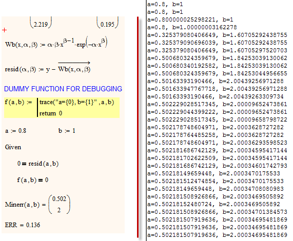

Hi:
My code contains 3 parameters (x1,x2,a2) and uses minerr(x1,x2,a2) to shoot a minimum error.
In the code, I first give 3 initial values to x1,x2,a2 (Ex: x1=3, x2=3, a2=3).
Then minerr(x1,x2,a2) returns me another 3 values of x1,x2,a2 (Ex: x1=1, x2=1, a2=1).
My question is:
I know minerr() utilize LMA to find x1=1, x2=1, a2=1 after several loops.
Is there any bulit-in function or written code can be use to record how minerr() find x1=1, x2=1, a2=1?
The reason of asking this question is for code debug purpose...
Best answer by Werner_E
OK, I've been thinking about it and have found a solution. If you use a dummy function which contains trace commands you can follow the algorithm if you turn on debugging. Don't forget to remove the dummy function and turn off debugging when not needed as it will slow down operation significantly and I know from a former thread that you have very long running iterations 😉 Did you came to a solution there?
I tried with an example from the quicksheets - see attached
Instead of using trace you could write the values of the parameters to a file and as you can also read files in that dummy routine you even could make a counter counting the iteration steps. But of course disk reads and writes would slow down operation even more.
I still wonder how tracing the LMA would help you in any way.

As far as I am aware there is no way to get interim results using Mathcads minerr().
But then, why would you like to debug a built-in routine? You don't have access to and can't change the code anyway.
Unless of course you write your own minerr routine 😉 But then you could throw in your own trace() commands for debugging purposes, too.

Got it!!
I try to avoid writting my own minerr routine at this moment (a big pain).
I don't think minerr() has any problem and just want to look how parameters change in each loop.
The problem I am facing now is: the code gives me the unwanted result and even disobeys constraints I setup.
Since the code can run, I don't know know to fix it (I checked the code structure with my advisor and he said the structure is fine).
I hope MathCad has the same function like Labview to show the parameter change in an animation way.
