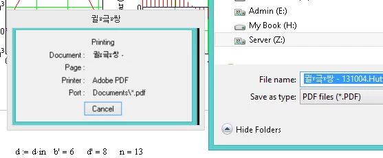

For now I'm back to M010 in Windows 8.1....no issues with 8.1 except for when I print to adobe PDF, the filename has some Asian characters in the filename. I attached a screenshot of this issue. I can live with this. This didn't occur in W7

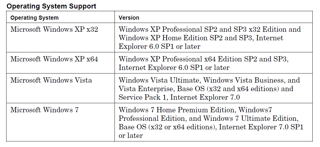

Strange problem to say the least.
Is Mathcad 15 compatible with Windows 8?
Do all the files you tried have Asian text?
Mike
February 6, 2014
Operating system support (for Mathcad 15 M030 service release):
February 6, 2014
Cheers Vladimir,
So the answer is no.

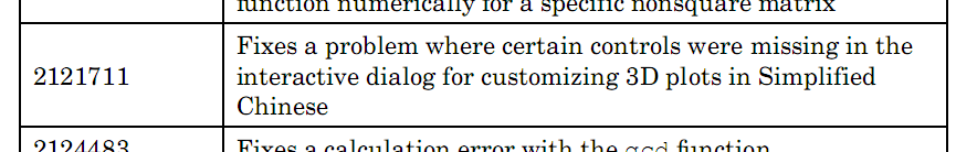

So the question is going back to Morris: Do your sheets also contain 3D-Plots which may be the cause for the slowdown?
I just flipped through the readme.pdf of MC15 and the only fix applied in M020 relating to 3D-plots I found was
Doesn't sound like a turning off of hardware acceleration or the like.
