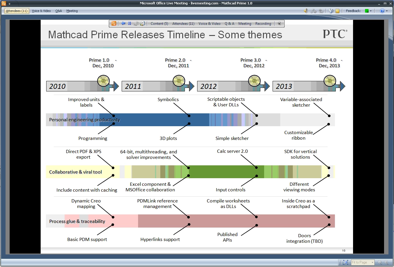

Well, the possibility of "Automation API" are also not included in a future release Mathcad Prime 2.0 (release is scheduled for Q1 2012). You can see the Roadmap for Mathcad Prime in the attached file. Why do not you use for your purposes Mathcad 15?

Vladimir,
Mona recently indicated that the roadmap is only a 'snapshot in time', so the features might not actually be implemented in that order.
