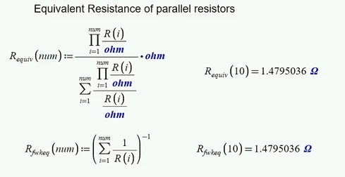

23-Emerald I
Sep 24, 2022 11:59 AM UTC
Very nice calculation!  Well done!
Not criticisms, just comments:
       1)    Not sure why you changed the default ORIGIN.  If that's your default choice, okay; but understanding somebody else's sheet may be confusing,
      2)  (And, IMHO opinion, more important)  Don't divide out units in functions unless you absolutely must!  Your equation for total resistance stripped the units.  (I know why,)  But you didn't need to, and the equivalent equation is simpler and  easy to visualize:
Welcome to Mathcad!
Sep 29, 2022 9:30 PM UTC
Fred:
Thanks for the comments.... I should have simplified the equation a bit!
With regards to the ORIGIN change... the thought was that I wanted there to be no R0... R1 was to be the first resistor.  In playing around with the code though, it appears it works a bit differently that I had understood. Working on that...
thanks
Adam

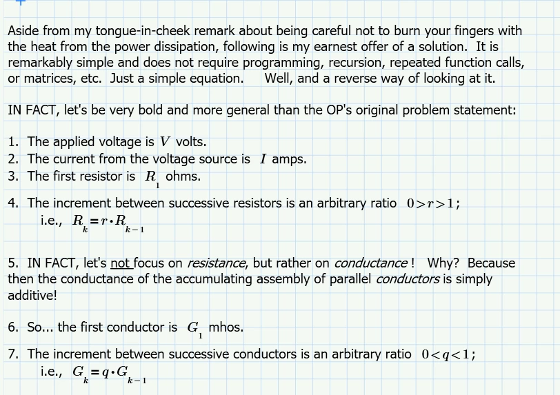

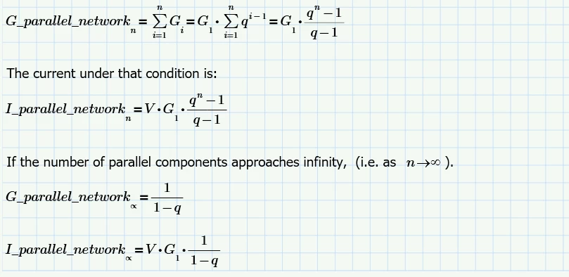

Hi Dave,
Yes, you generated a lot of interesting responses!
I hope you like my simple closed-form expression for the solution – that didn’t even use Mathcad. No offense intended in doing that – have used MCD for EE work since its DOS version.
Strib
