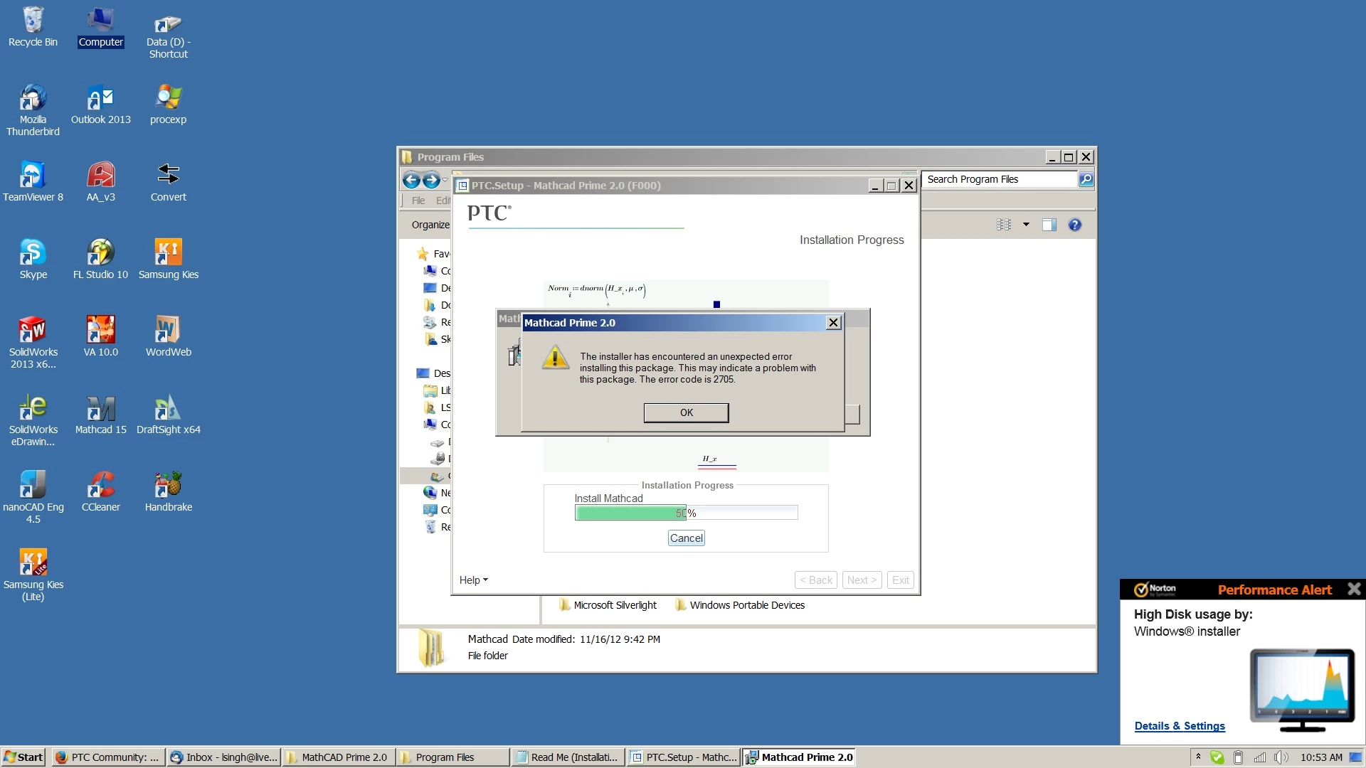

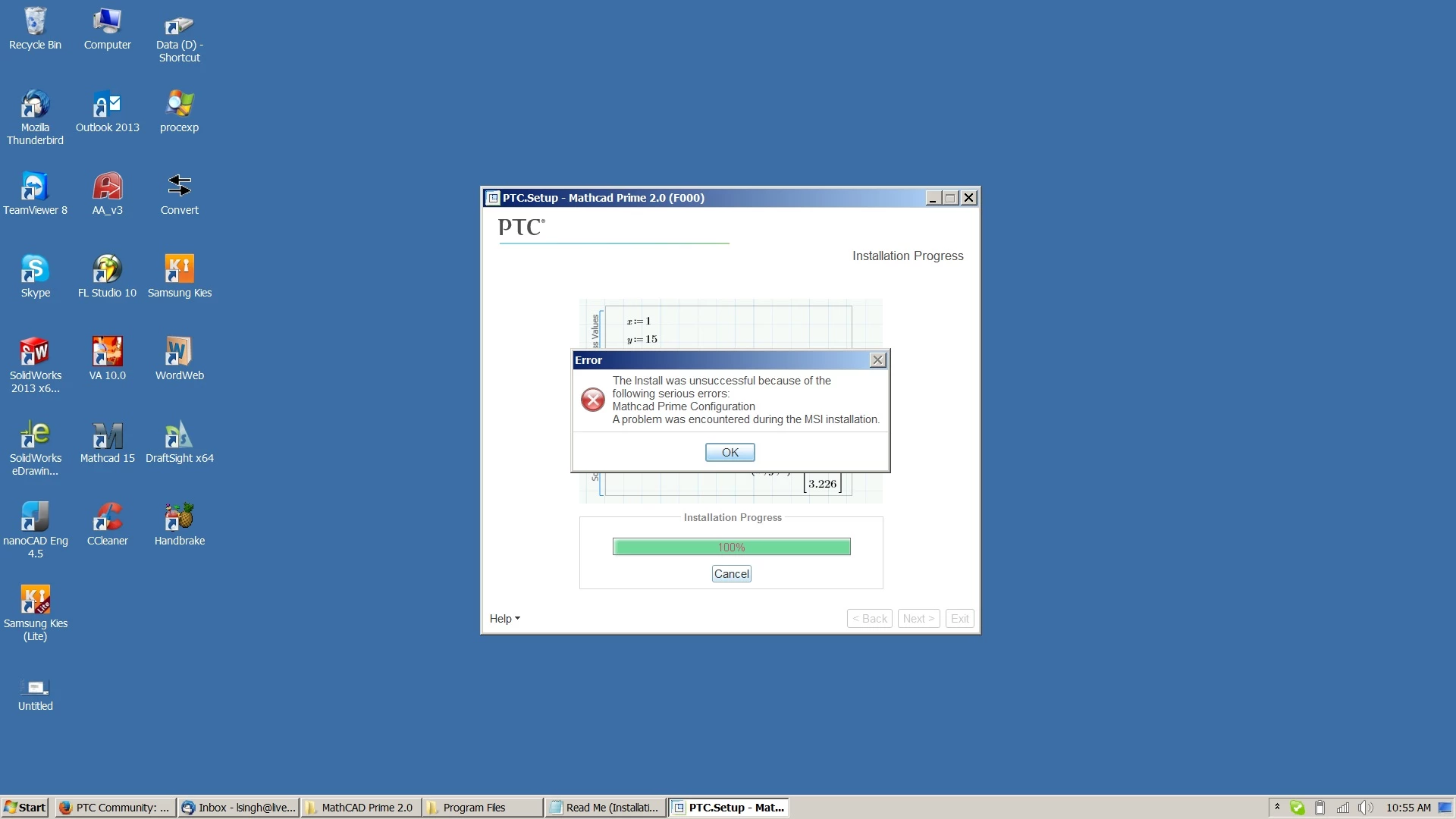

1. First it says that the "error code is 2705".
2. Second it says that "a problem was encountered during the MSI installation".

September 28, 2013
So the problem is not that Prime stopped working as that would mean for me that an already installed version, which used to work, suddenly refuses to do its job.
Your problem is that you cannot install Prime on your computer. Was Prime already installed on that machine and worked properly?
From the error messages (which are not of any help to me) it does not look like its a license problem. Nevertheless you should check how many installations the version you bought allows. If you intend to move your license from an old machine to a new one, PTC support should help you to get a new license file.
As I see from your screen shots you are using Prime2 F000. You may consider to give the current maintainance release M010 a try.
