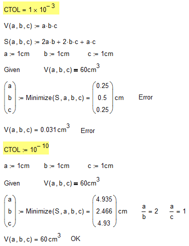

The problem with CTOL and TOL
We must do CTOL and TOL := 10^-10 or work with m not cm - see please the attach

Make the Minimize solve block a function - see attached.

I am not sure about the problem you are experiencing. I guess the problem you posted in your sheet is not the problem you actually want to solve. In your post you wrote that you want first to maximize one problem and use the results as guess values to minimize a second problem. In your sheet you are simply trying to do the same minimization twice which doesn't make much sense as does the condition >=60 instead of =60 as it must be clear the volume in the problem you posted has to be exactly 60 cm^3 (if a solution would be found for a greater volume you could cut the height and get a better solution).
Basically your sheet has the structure
Given
... constraint(s)
Sol:=Minimize(....)=
You have to think of "Given" and "Minimize" as opening and closing parenthesis.
So the second time Minimize is used standalone without a solve block (no associated Given). It will use no constraints and the current values of l.min etc. as guesses (which are the initial 1's in your sheet!). This standalone Minimize fails with an improper error message (variable not found) because we would get a minimum (w/o constraints) for variables being minus infinity.
If you move the second Minimize above the first it gets associated with the given and the other will be the one which is standalone.
So in case your original problem requires two different optimizations with different constraints, the solution is to use a solve block for the second optimizatioin, too. Keep in mind that constrains only are considered if the are stated IN the solve block (between Given and Maximize, minimize, Find, or ,,,,).
If the problem you posted really is the one you want to solve, see the attached file. There is no need for a second minimize.
If you chose the more elegant way and add units to your variables from the beginning as Alan had doen, you will have to change CTOL to a much smaller value than the default 10^-3 as Valery suggested because Mathcad will use its tolerances on the values in base units (meter in your case).

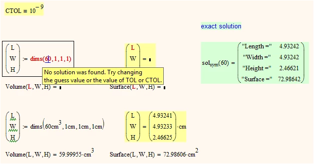

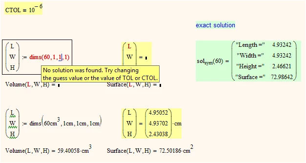

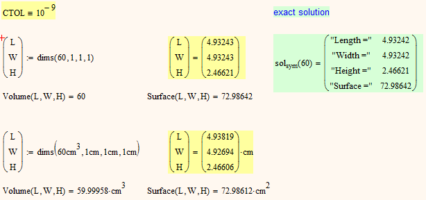

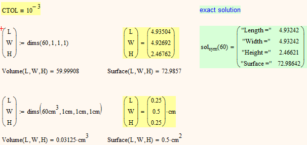

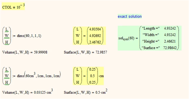

OK, I have recreated the worksheet and set it up to be able to compare results with and without units for different values of CTOL with the exact solutions derived symbolically. The solutions depend rather heavy on the guess value, better guesses give better solutions. If we look at the 3D-plot we see that the area around the minimum is rather flat, so small steps will not change the surface area much and the algorithm stops (too soon) according to the convergence tolerance set. Given that 1cm^3 = 10^-6 m^3 I would have expected the same results for (no_units & CTOL=10^-3) and (units cm & CTOL=10^-9). This is pretty much true, but not exactly. Also for (no_units & CTOL=10^+3) I get similar results as with (cm units & CTOL=10^-3) which is also as expected. So far no bug, just a word of caution when using those numeric approximation algorithms with units different from the base units.
But .... from the previous posts it looks like different people get different results from the very same sheet. Can anybody confirm that with this sheet and post screenshots if he/she gets different results? The screenshots below are the result of using Mathcad 15 M030 under Win XP.

For CTOL = 10^-3 I get the same, however, for 10^-6 and 10^-9 there is no solution when the units are not included, yet the values for the other solution are different and also differs from yours.
I am using Mathcad 15 M010 on Windows 7
March 7, 2014
I just loaded the file on a different machine (but still MC15 M035 on Win XP) and got the same results as those I posted the screenshots of. However with CTOL=10^-6 I also get no soulution without units. Better guess values cure the problem of course as the problem is quite sensible to the guesses.
But the different results you get a scary. Guess its not the operating system but the MC version (M010 vs M030)?
