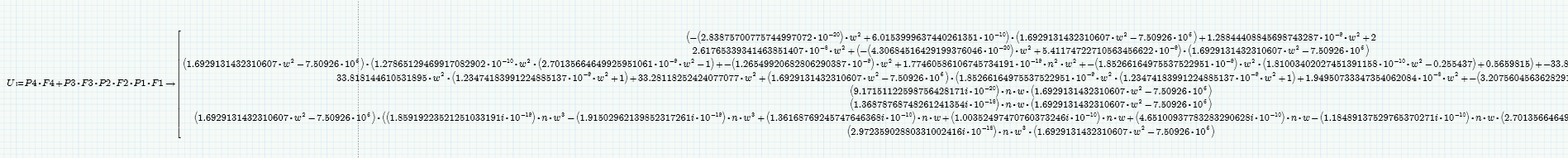

Here is what I have so far. My apologies for the size of it.
Basically I have identified [F4], [F3], [F2], and [F1] matrices, all of which have known values.
I then identified [P4], [P3], [P2], and [P1] matrices which have unkown variables "v" and "w" present.
I then try to symbolically multiply [U] = [P4][F4][P3][F3][P2][F2][P1][F1] but it becomes too large to display, so I have to do iterations of this and simplify it. For example, [U22] is the matrix of [P4][F4][P3] after it has been simplified. I conitinue this process and luckily I get a result, [U6] at the bottom which is the overall system. However, it is red and quite honestly it is difficult to work with.
Is there any easier way to do this?
I have a couple more problems with this but I'll focus on this part first.
November 28, 2012
Your final result displays because you added a numeric evaluation to the expression, not because you did the calculation in small pieces. That is an undocumented "feature" (i.e. a bug that works to our advantage ). Actually, I didn't realize this "feature" existed until I saw your worksheet. The problem with that approach is that the result can't be used in a subsequent symbolic expression. An alternative is to look at the matrix a column at a time. Creating a polynomial function in w and n is easy, but I don't know what you are going to do with it. I don't know any way to find all the roots of a polynomial that goes to the 24th power in w and the 8th power in n.

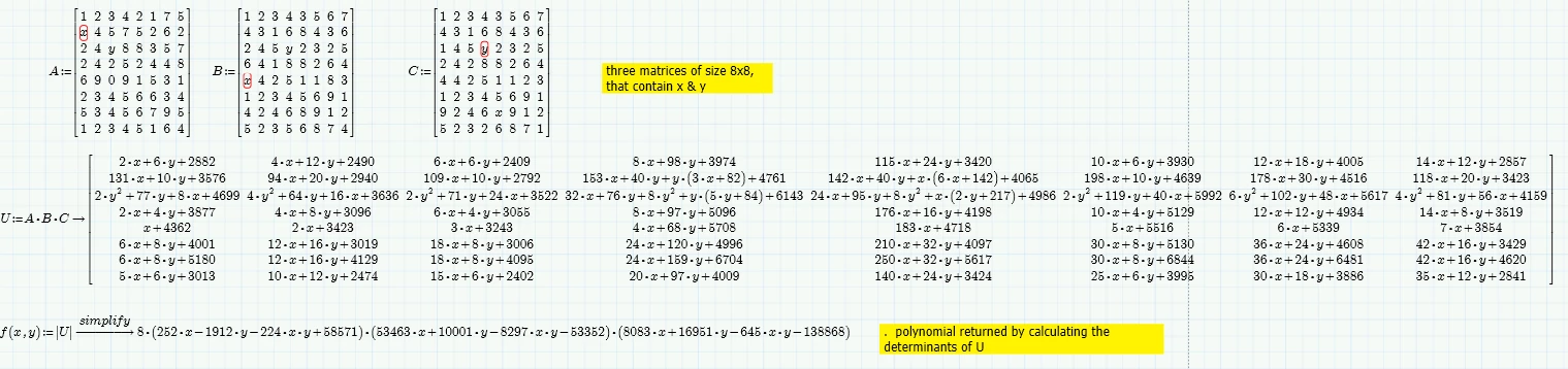

Not sure I have got exactly what you are attempting. And I'm not sure which version are you using?
In Mathcad14/15 you get the warning.
But you should still be able to calculate the determinant of U, regardless of this warning as the result does get saved to U.
I tried this is Prime 2.0 and you can see the matrix U
I've attached the prime 2 file and the PDF of the calculation.
I used a surface plot to show the function of x and y.

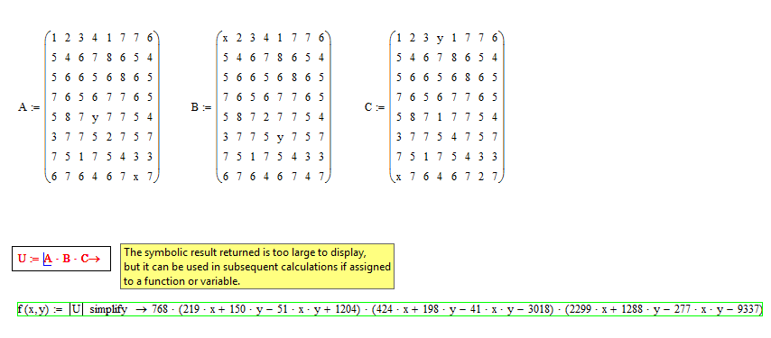

I removed all the imtermediate steps and converted this to Prime 2.0 and calculated the Matrix product in a single step.projectcalc_prime2.png
I've only copied part of the solution here...but it extends way off into right hand side!
Mathcad 15 & Prime use the same symbolic engine...
