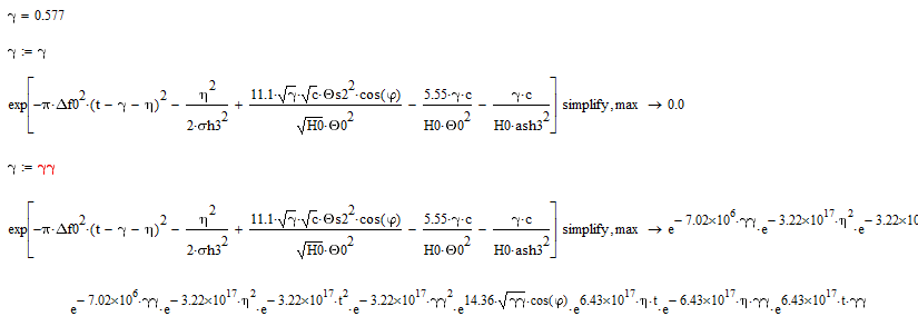

I can`t to make numerical integration of function Pko(t) and Pno(t) but Pno(t) exists analytically

No solution, just some observations:
Pno(t) does not throw an error but yields constantly 0 as result, which, as I guess, is not what you expected.
When I symbolically evaluate the inner integrand it surprisingly simplifies to zero. This may be due to the fact that gamma is a predefined constant. But writing gamma:=gamma should make it "unknown" at least to the symbolics - has no effect in this case. assigning gamma:=something different yields a non zero result! ?
Nevertheless, replacing gamma for some other variable name in the definition of Pno(t) does not change the result (0 for all arguments).

No, I didn't look at the word document. Did you typed in the result (wherever it may stem from) in Mathcad, did you plot it and could you prove its equivalent to the expression you presented in Mathcad?
Sometimes it may help to replace infinity by a bigger real number, but in your case the problem with Pno seems not to be the integrals but that the integrand simplifies to zero. Even with another variable instead of gamma, if this variable is bigger than 4*10^-6 the integrand simplifies to 0 - and you are integrating from 0 to infinity!
