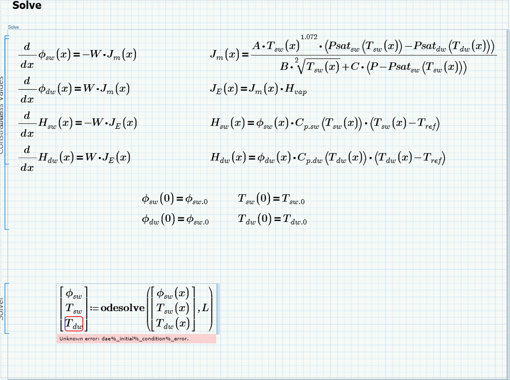

Hi all,
This is my first post here on the PTC Community. I have a question regarding an ordinary differential equation solver.
I just simply do not understand why it can not solve the equations with the constraints provided.
I did not miss any initial conditions.
The document is about a membrane distiller, where the temperature is variable along the length of the membrane. The change of length is stated as x where the temperature becomes a function of x. Also the mass flow and flux will be a function of the length of the membrane since the mass flow at the seawater section loses mass that goes to the demiwater section.

I think you're too complex!
You really have only three functions to solve: T_sw, T_dw, and phi. (phi_sw = -phi_dw, and H and J are combinations of the other three.
Try recasting the problem for those three, see how you do.

It do sounds like a problem where it would terminate the calculation. Though my second task is to plot the functions J_m(x), phi_sw(x), phi_dw(x), T_sw(x), T_dw(x), Psat_dw(T_dw(x)) and Psat_sw(T_sw(x)).
Would it still be possible to plot these since these are not solved in the odesolver?
After deleting the combinations out of the odesolver, it comes up with a new error:
"dae%_initial%_condition%_error"
If I rewrite the inital conditions of all functions like in the .mcdx file, but keep the odesolver like in the image above, the problem persists.

Took a closer look:
You have two functions Psw(T) and Pdw(T) that aren't defined, and you need them defined. You need to write your equations in T and phi, remove the J's and H's.

Prime often fails with labelling the variables - so look if the labels of all functions (definitions and calls) are the same.
