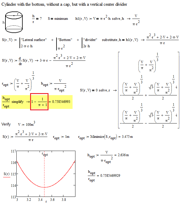

Can you find a symbolic solution for this
and others same (r-h) bodies

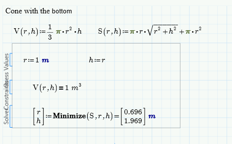

Is 2*sqr(2) the symbolic solution of ths new problem
Sorry but I can not solve this problem with new solver of Mathcad Prime - see attach. May be I do some wrong?
December 5, 2012
Valery, your file works ok for me - see below. All I did was load it into Prime and then click Calculate from the Calculate menu! This idiosyncratic behaviour seems quite common in Prime!
