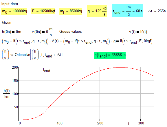

I can not solve this task in Prime (with units) Help me please!
In Mathcad 15 - no problem (see the attach). We can add air resistance, g=f(h) etc
One North Korean rocket
April 15, 2013
This is similar to the use of alcohol - first bad, then good, then bad again:
http://communities.ptc.com/servlet/JiveServlet/downloadImage/2-202255-48605/450-338/rocket1.png

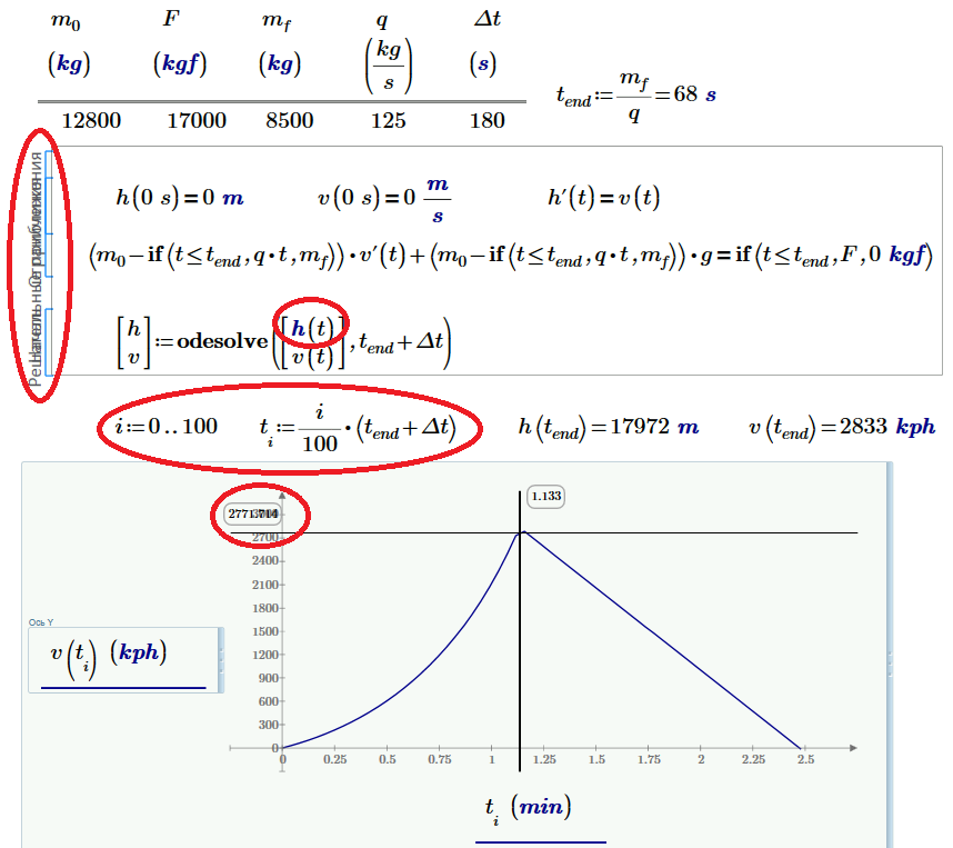

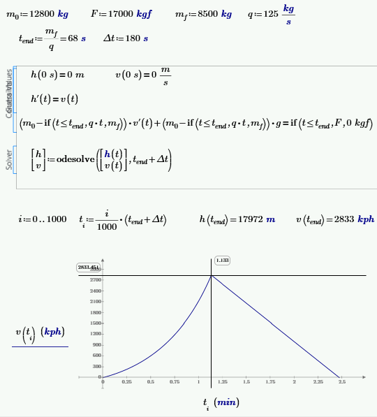

It seems starightforward enough in Prime 2 - see attached. Perhaps I'm missing something?
Alan
April 15, 2013
Thanks, Alan!
I have done it too by help the Mathcad 15 Mathcad Prime convertor.
But I cannot do it direct.
Questions (2 old and 2 new) on the picture:
April 15, 2013
Valery Ochkov wrote:
Thanks, Alan!
I didn't use the converter (I still only use M15 F000, so the converter doesn't work), I did it direct without any problems. In answer to your red questions: I also get the mess of words on the side of the solve block; and the blue h of the h(t) in odesolve; and the messy looking marker label. By increasing the number of -plotting points it is easy enough to get rid of the velocity glitch near tend:
Alan

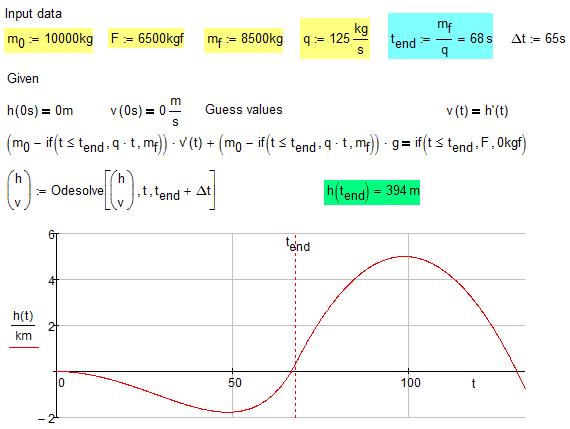

April 16, 2013
The first part of the rocket flight - is a virtual flight (h=0). The rocket is on the start platform and burns fuel (m.f) as long as its weight (m*g) becomes (10 9 8 7 6 5 4 3 2 1 Zero) equal its engine thrust (F)
April 16, 2013
O
I don't think the calculation shows this. At the end of the calculated "virtual" flight there is a significant upward velocity! If the rocket stayed on the platform just burning fuel it would have a zero upward velocity at the point of take-off.
Alan
April 16, 2013
Yes - no limit to improve calculation
Add h=g(h) and air resistance - with cloud functions!
http://twt.mpei.ac.ru/ochkov/T-2012/rocket.png
