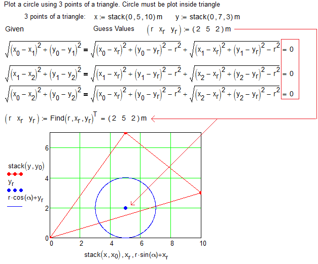

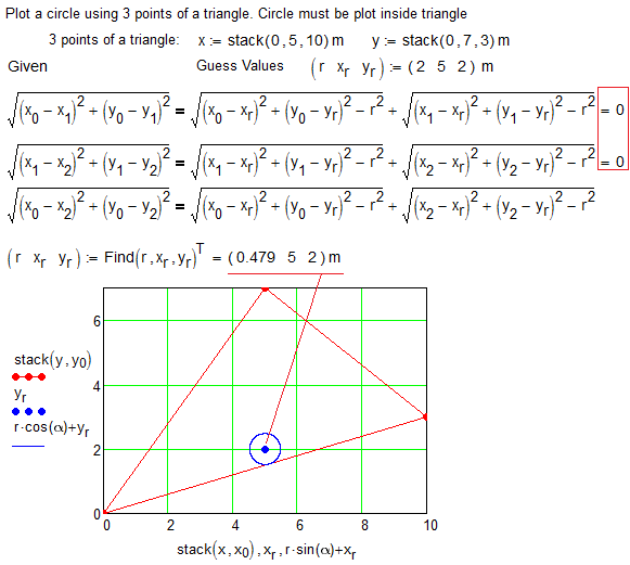

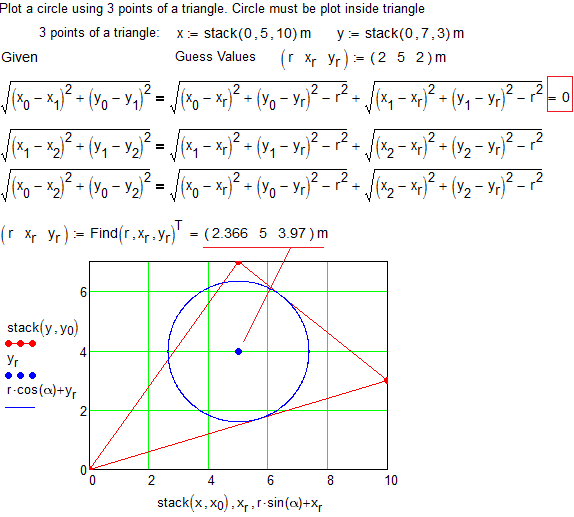

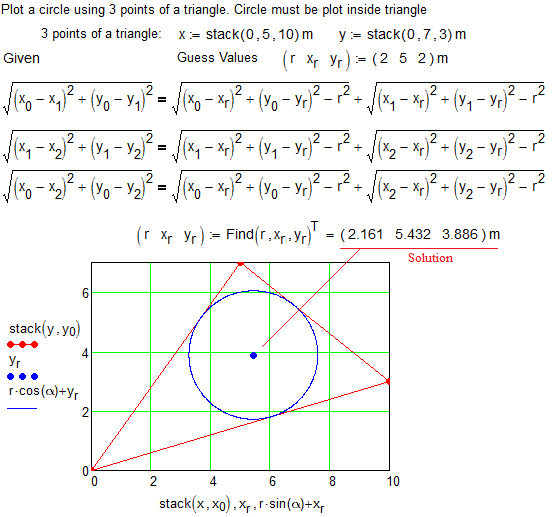

We can use operators "=" in solve block for the check - all variables is defined. Than we can delete operators "=" and get answer:
