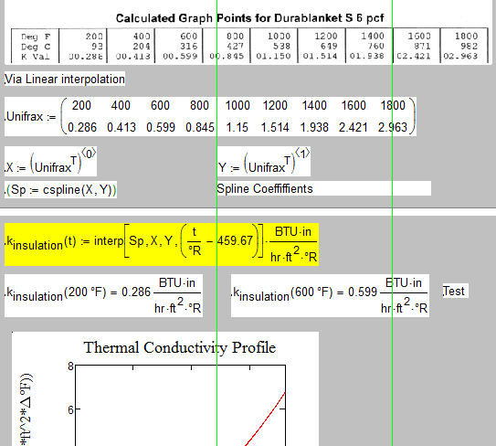

Long time no write. I am attaching a Mathcad v14 file where I am attempting to solve the required insulation thickness using temperature and insulation splined functions. I know this is a multiline curve fit. At the bottom, you will notice two functions. If I disable the one on the left and turn on the one on the right, the graph works. As a by product, I will then need to figure out why the function generates a [2,1],1 vector

Updated file. Had "t" defined multiple times from another sheet I worked out. Still not getting a single answer when fixing the thickness and time

Narrowed down the problem. The array dimensions in the denominator do not match! Seems so simple ... brain is fried
March 24, 2012
The "thick" variable is an array and there is no index for it in the argument in the last plot.

March 25, 2012
See revised file
  • Fixed function definitions.
  • I still can not get the "multicurves" to plot (expect flybacks).
  • Help in finishing sheet. Questions embedded in worksheet and highlighted in yellow.

March 25, 2012
My students keep in mind the constant 273.15.
I think that American students must keep in mind the constant 459.67.
Correct work with US temperature unit in an empiricl formula:
March 25, 2012
I see than we use not correct Thermal Conductivity units in Europe and in USA:

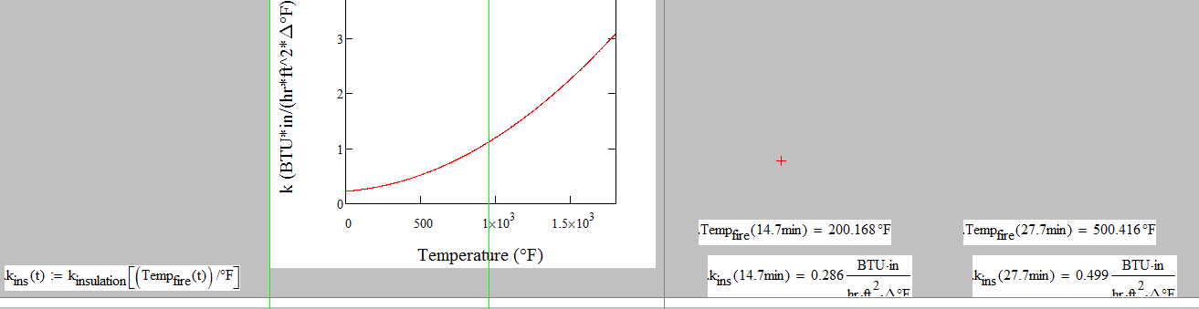

March 25, 2012
Valery, my equations are correct. Use t=14.7 minutes (~200F) and it gives the same answer. Test at t=27.7 minutes to and k=.499 which follows the curve. (NOTE: max temp is 530F)
I believe that I need a program instead of a solve block in the highlighted "yellow" sections below.
March 25, 2012
You would like to find a minimum of the function of one argument?
Ath first You must to create the function of this function.
