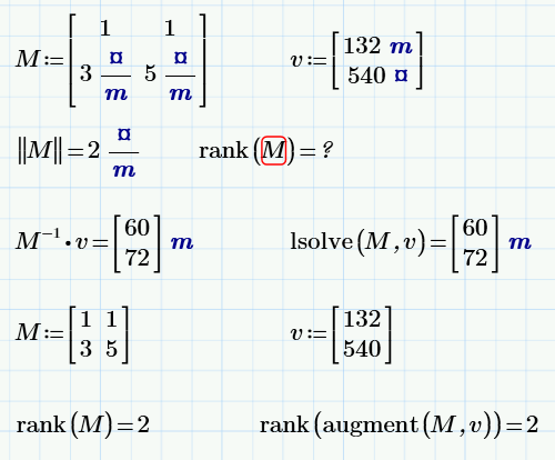

I think it is an error. Or?
December 21, 2013
I don't think it's an error. To find the rank of a matrix one has to perform some operations that involve subtraction of terms from different rows. This only makes sense if all the terms in the matrix are of the same type. The determinant works for your examp;les because items of different type are only multiplied together (which can make sense).
Alan
December 21, 2013
Fully agreed. I, too, won't consider this an error.
And thats the reason the numeric processor fails - its aware of units. While I don't consider it a bug or error I can see that it could be convenient if Prime would see the unit not as a real unit but rather as a simple factor in that case.
The symbolic processor is not aware of units and treats it as normal (unknown) variables. Consequently a symbolic evaluation works.

As the symbolics is not aware of units its right.
But using a modifier like "fully" I would have expected muPad to give me a more complete result by telling me, that the rank = 2 only if V is not Omega*A and its 1 otherwise.
