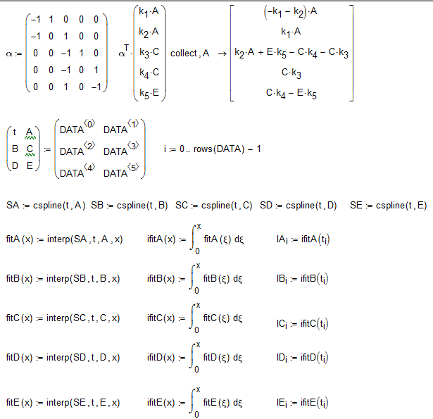

Again in the book "chemical kinetics with maple and mathcad", chapter 4 introduces different ways for rate constants determination.

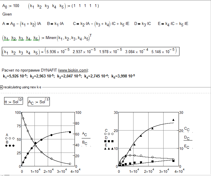

Take figure 4.8 as an example (corresponding attached file is "Fig_4_08_PineneIsomerization_InvTask_MC14" ), numerical integration method is used searching rate constants:

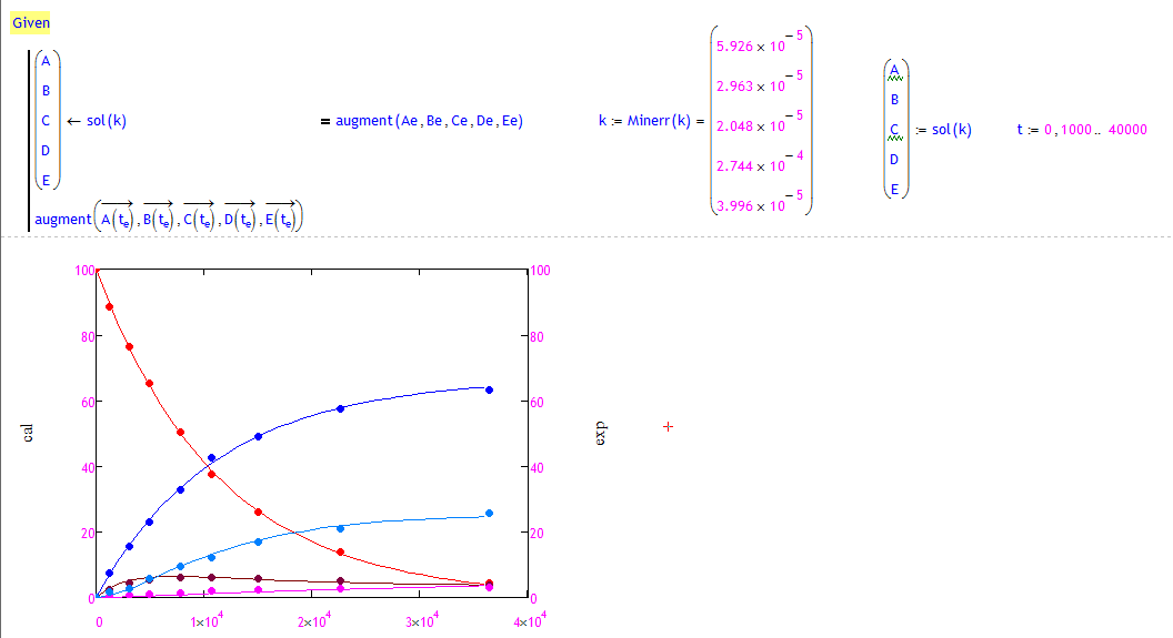

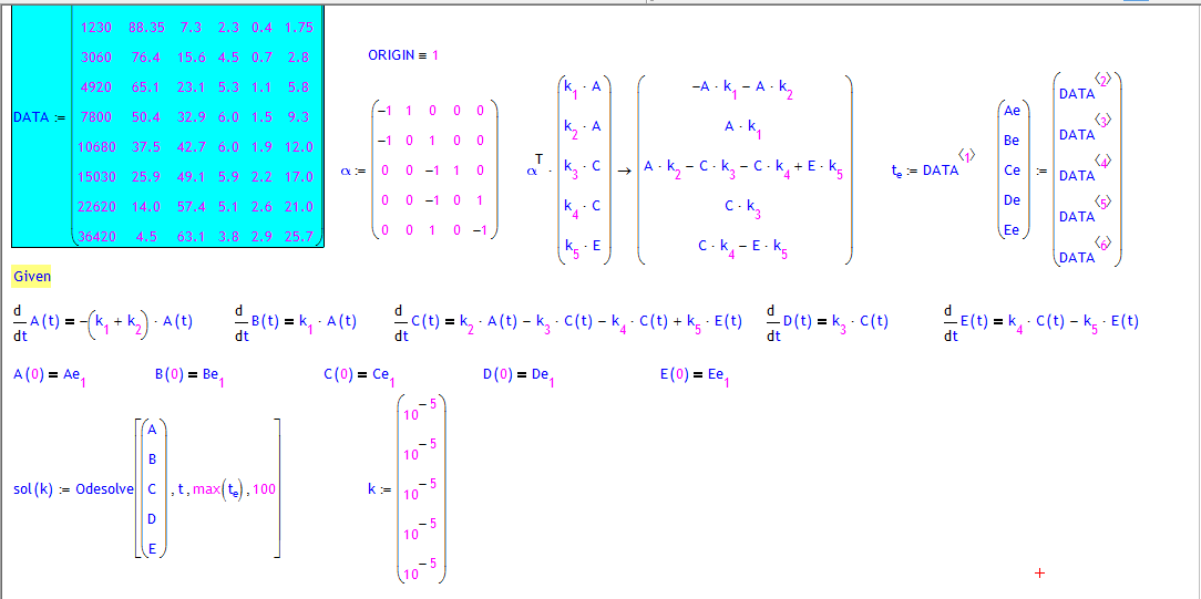

but i think that solving ODEs is more direct and general than integration method, so I solve the problem with ODEsolve method:
Both methods looks good enough, but differential method results are closer to that of DYANFIT than for integral method.
But differential method seems much more initial-condition sensitive than integral method, e.g. if guess values of k1--k4 are all set to 1, the calculation will be very time-consuming. and I dont know how to improve this situation.
Does anybody give any suggestions on "lowering/ reducing" the initial - condition sensitivity of differential method?

Try basing your initial guesses on the information available to you from the basic data and, where possible, the form of the equations. See attached.
Alan
Improved file attached
July 3, 2013
For parameter estimation, all parameters should be scaled to the same order of magnitude and then you try guesses for two orders of magnitude surrounding the expected values.
July 3, 2013
Alan

Thanks. Alan
your method is very interesting, time-saving and skillful than mine. I appreciate very much. Now I got three ways of solving the problem, lol.
by the way, I think your answer is more educational than practical, coz the reaction orders are all integers, and this is not very often in engineering practice.
thanks a lot again for your very detailed answer to my question
