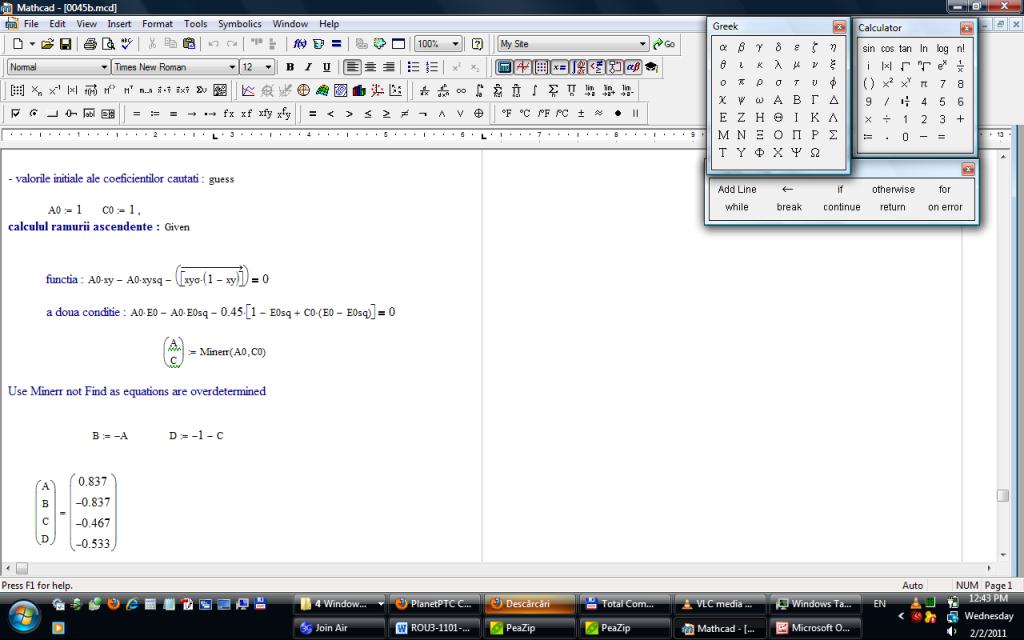

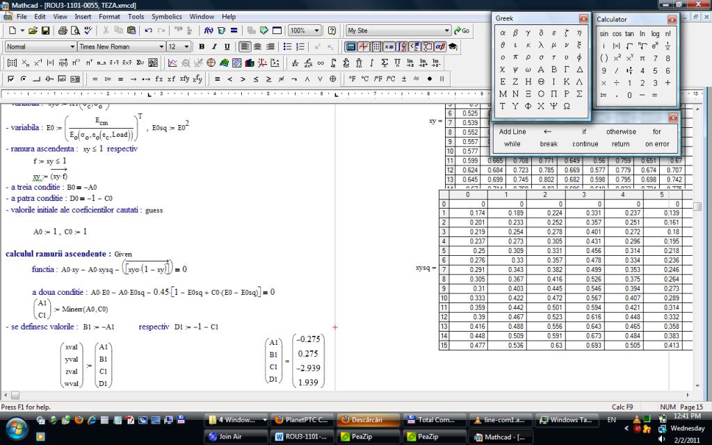

The problem I last faced is that the program attached by Alan Stevens (thanks) New Picture (13).jpg and copied in my larger file (not attached in the collab due to dimensions) gives another set of values..New Picture (12).jpgA1 stands for A and so on (C gave a definition error so I added the "1" to overpass that)

If you cut and pasted the routine from one file to the other, then any difference must be due to differences in data that go to making up the XY, E etc matrices and vectors, or some difference in the way they are defined. Without seeing your larger file it's not possible to be more specific.
Alan
February 2, 2011
No, I see the problem. You don't have xysq pictured, so you must have evaluated it before the definition of f and the xy.f evaluation. xysq must be calculated after xy.f..
Alan
