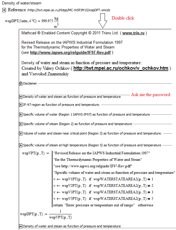

I use subareas in my "cloud" Mathcad-functions. See the picture and try the attached Mathcad 15 file:
October 29, 2012
Can not see any subareas, which you asked for, in Valerys document. Probably his point is, that you can split your inital sections into separete worksheets and reference them from your main document - as Fred already pointed out in his post.
This feature is a long standing wish of the community. I remember darkly a discussion (here or better yet in the collab) about that wish and I think someone was able to copy an area from outside into another region, thus nesting areas. I just tried it with Mathcad 15 and failed. Anyway - that workoround was considered dangerous because it is not documented and so there is no guarantee it would work in future releases (probably exactly that happened).
