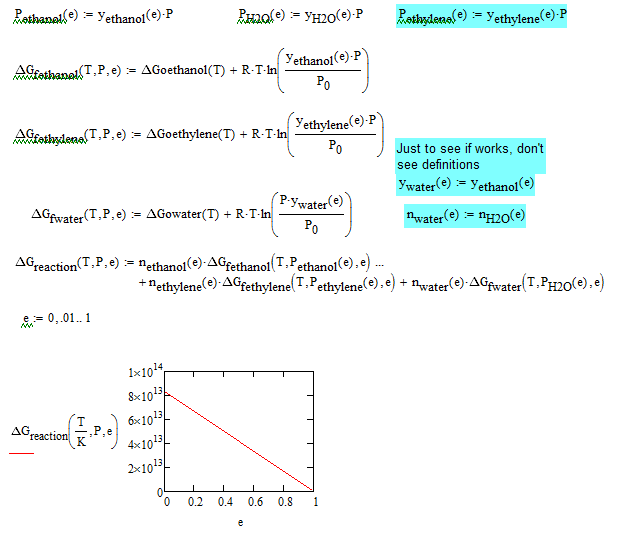

I don't understand why it doesn't like my ∆H expressions (the one that use heat capacity). I'm talking about ∆Hethanol(T), ∆Hethylene(T) and ∆Hwater(T). From there I think I can figure out what's wrong with the rest of it, just need to know one to know the rest. It doesn't come up as red until you enter the = sign.
Also, do I need to do a solve block before ∆Greaction(T,P,e) to get it to graph? I just can't tell because of the errors.

The expressions do work, just not in line. Evaluate next to the expression. Sometimes this happens.
By the way, they are not actually functions of T, T is inside the integrals, which have fixed limits.

Some of the functions are not defined, put a couple of artificial ones in

Thanks for catching some inconsistencies. But my problem was evaluating the ∆H expressions. Anyone know?
