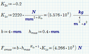

i have to do a lot of calulations for differend tasks in the field of "Cutting and Erosion Manufacturing Engineering".
We have to deal with a lot of functions like you can see in the worksheet. I love MathCADs ability to deal with Units, but in this case it can not. Is there a way to work arround this error, or do i have to throw out the Units?
Peter

Are you sure of you equation? If this is brittle fracture, K1c should be psi x sqrt(inches) or N x sqrt(mm).
December 18, 2012
Empirical equations of this form are always difficult.
I'm guessing but I doubt that you want results that include fractional exponents. so all of the mm^-0.2 factors must cancel out.
So , possibility 1 is that you write the equations cancelling the rejected portions out & adding corrction factors to account for the difference.
Difficult & prone to error & requires a lot of documentation to ensure that the reasoning does not get forgotten...
The 2nd possible solution is to use the symbolic processor to simplify the equations down & when there are required results convert them back to the numeric processor.
The symbolic engine has a distinct advantage in this case as it does not take account of the units it only sees variables. so no conflict with mm^-1.8.
However you will still need to exercise great care as there may be cases where the units don't cancel correctly.
I've only used this in a couple of circumstances where I know that it always works.

This is slightly off-topic, but the constant in exponent constraint was lifted in Prime.
