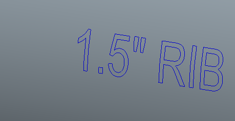

Hi folks,
How to emboss a text similar to wrap by using offset "with draft feature".
Problem is here, while i am trying to put text to emboss on circular part its spreading over that part.
I want to emboss text on circular part with same size.
Could you please suggest me if there is any way?
thanks
