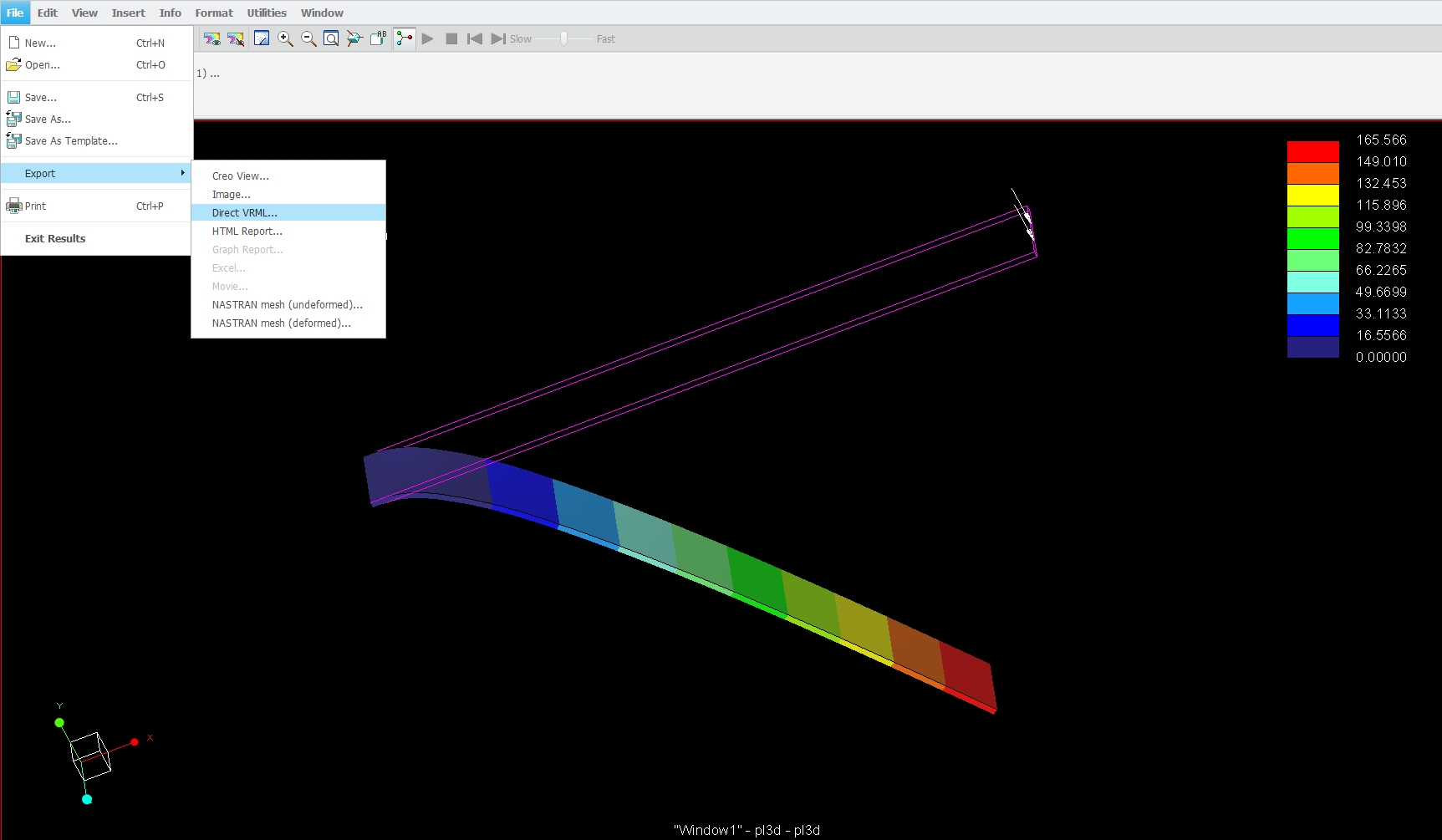

For example, I make static analysis for spring deformation. so I want to export the deformed spring to original 3D model (not in simulation mode) for detail check, is it possible to do it?

yes, step 1: export VRML

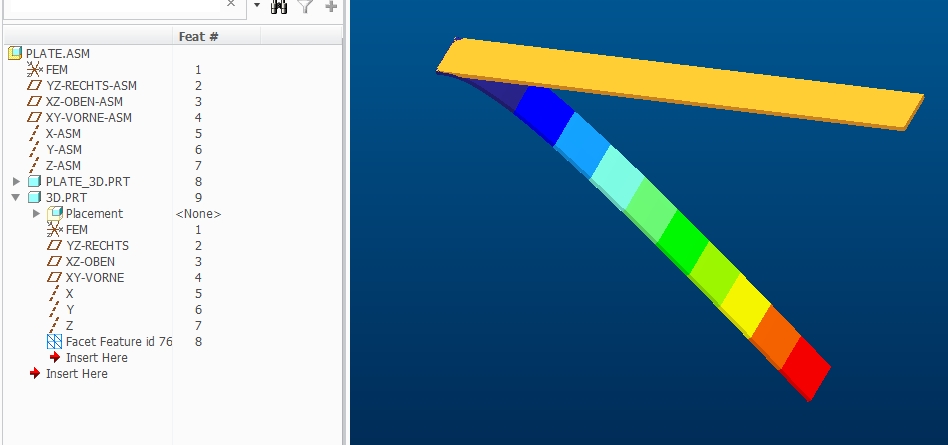

step 2: import

creo 3 and later:
