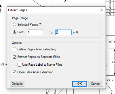

Since our old system (pre-pdf's) was set up that each tab on a DRW was set up as a separate DWG. It has been decided that each tab needs to be a separate PDF. Any thoughts on how to separate this out? Either during the export process or after the fact?
We do not have a large amount of multi-tab(sheet) drawings, so separating them after export could work too, but during the export process would be even better.
Best answer by Dale_Rosema
Pro-Work Around:
I save the drawings as .dwg's (which is only single tab per page) and then save the .dwg's to .pdf's.
Not pretty, but a solution for now.
August 18, 2022
After the fact, most PDF editors will break out sheets as PDFs. I use Bluebeam but I think most do the same.
You might be able to make a mapkey that would do it directly from Creo!!! Just don't expect to be able to add text in from of the filename!

Currently I am opening the multi page pdf and printing to a pdf 1 page at a time.
August 19, 2022
You can create AutoIt script.
Usage:
  1. open drawing
  2. activate 1st sheet
  3. run AutoIt script
  4. AutoIt script displays window which enables you to set prefix of PDF filename (-OR- stop script execution)
  5. set prefix and press OK
  6. AutoIt script generates savePDF trail file -AND- makes Creo to replay savePDF trail file
  7. AutoIt script  pauses and displays window which enables you to set prefix of PDF filename (-OR- stop script execution)
  8. activate 2nd sheet
  9. repeat steps 5 (AutoIt repeats steps 6-7)
  10. and so on ...
