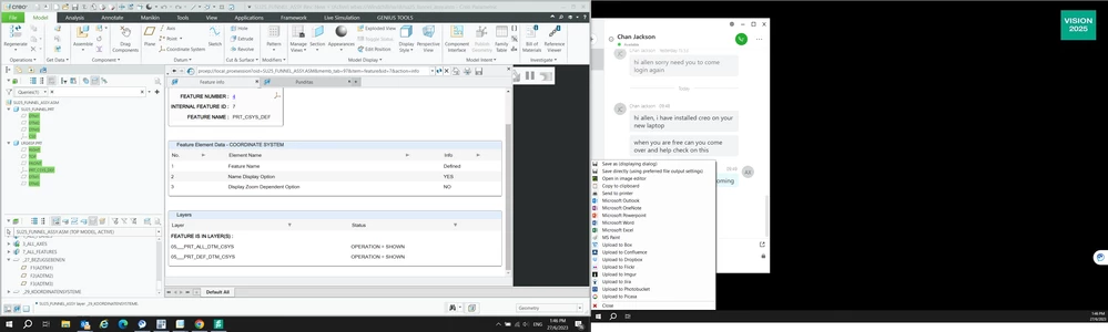

Hi, I am using Creo 9 and got this problem in an assembly environment.
When I assembled a part to a sub-assembly and I encountered this problem that all the datum of the part cannot be seen. From the model tree, I could see the datum (layers, axis and DTM_csys) are grayed. But when I chose a grayed datum (such a plane) and checked its information and found its status is "shown".
Similar problem occurred to another part created in the assembly environment, I could not see its "Axis". Though its planes are shown.

please play attached video and read https://www.ptc.com/en/support/article/CS291373 article.
open part in separate window, select item greyed in model tree and apply Show command from minitoolbar.
Thank you for the help. Actually all the datum are shown in a part environment. I can hide/unhide with the plane display. but in the assembly, the datum are grayed.
below is the part model tree. you can see all the plane are shown and have no problem.
switch to the assembly and show me datums in model tree.
Hi Martin, please see below model tree and layer tree. thanks.
again ... select item greyed in model tree and apply Show command from minitoolbar.
you mean this toolbar? the planes are still grayed.
or below one?
It appears that you have some of the part datums layered off. Select all of the layers and then right click and click "show" from the context menu
Thanks to all the helps.
please see the attached mp4.
All of the grayed datum cannot be switch on because no "show" tab in the smalltoolbar. And, the problem happens only in the sub-assembly but not in the main-assembly. In the main-assembly, all datum are not grayed and can be "show/hide".
Thank you very much. Problem resolved.
