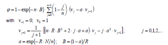

Everyone,
I am trying to set up a summation equation the that uses a combination of a current instance of a variable as well as the previous one. Anyone have any idea on how I would set this up?

Please post a Mathcad sheet with your current attempts. You have better chances of somebody taking care of cour question that way, as it shows which version of Mathcad you intend to use and it saves us the redious retyping work.
In your pic the definition of R and N are missing. Or should phi be function of the two?
In your case you would first define a nd B, either calculate them or set them up as functions of R and N if they should remain unknown.
Then create the vector v. As Mathcad by default begins with index 0, I would switch you formulas by +1 (this will also affect the summation, of course). j is running from 0 to n-2, I guess, as the las v used in summation is v index n-1?
Now you can setup the formula for phi, either as a function of R and N or as a constant.
Thank you for the assistance. n, N and R are all calculated else where
I have attempted what you suggestec but I am still having difficulty with defining previous instance of the variable. I have attached my latest attempy

As already assumed, your problem were the different types of indices.

Would this help?
or this?
Both options look valid to me
I guess where I am struggling is that I can't seem to create j-1 subscript. Is there a trick for doing this? Every time I add the the minus sign it places it in as part of the equation.

Depending on how many times you calculate phi I would recommend the first option.
Although the second looks neater it has to recalculate the 100 elements for v every time it is called, the first will only calculate them once & then it has a look-up table for the rest of the sheet.
Can be very much faster

Agreed, but as a later post of Mike revealed is n in the "magnitude" of 6 and it seems he needs to calculate phi only once for a given set of initial values. So I guess its up to his preference what to use. If he needs the values of a and B later or whats to see them, he will probably chose the first approach. The second would only make sense if phi is to be calculated more than once in the sheet or for a series of values of n or the like.
Thanks Werner,
I got this to work. The biggest problem was I wasn't working with the Matrix toolbar 🙂
