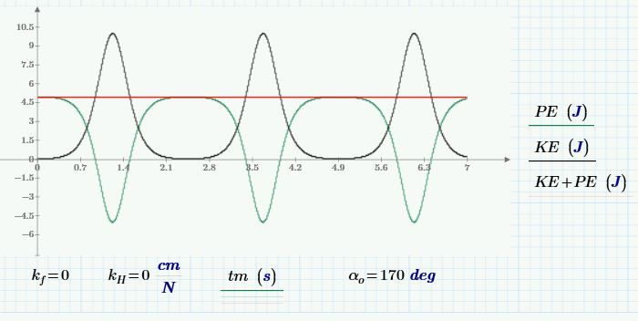

Pendulum Math model
ValeryOchkov
Pendulum Math model
Why someone is not correct?
See lpease the picture and Prime 3 sheet in attach.

First of all--it's Prime 6, not 3.  (Since I'm using 4.0 Express, I could tell.)
Second--Potential energy can't be negative (I understand why you're showing it that way, but . . .)
In the absence of dissipation, and if the pendulum is rigid, total energy will be constant.    So if we make kH = 0, we should get a graph like this:
I have put a marker here on the total energy level.  Now, if we let the pendulum be a spring:
The calculated potential energy is WAY TOO HIGH.  The kinetic has increased too, but there's only so much energy to start, and both calculations started at the same condition.

Sorry, a potential eneggy can be negativ - see please the picture (a hard link!).
May be the problem in the function for le.
You're right, of course; the potential energy is defined relative to an arbitrary zero point.

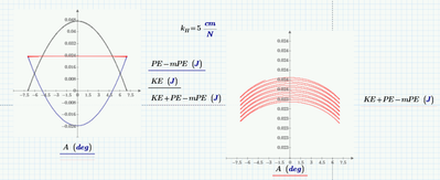

There are two potential energies to be tracked:
And two kinetic energies:
And, if I did it right (within calculation accuracies) they now track:

This represents two coupled harmonic oscillators: a pendulum, and a spring/mass.  Each trades potential energy and kinetic energy back and forth, so we need four energy calculations.  If we're not careful in our definition of reference potential energy (I chose the bottom of the pendulum swing, but that changes as the spring constant of the length changes) then the calculation will not be valid.  Take the pivot point of the pendulum as the zero potential energy point for the pendulum; all potential energy for the pendulum will be negative as long as the angle stays below 90°.  I also chose the un stretched pendulum length for the zero reference for the spring/mass.

a weightless non-bendable spoke that compresses or stretches according to Hooke's law.  This is a spring!  And the "physical point" is moving radially as the non-bendable spoke compresses or stretches.  So there is a fourth energy, the kinetic energy of that radial motion.

Note:
  •   The Prime sheet is 4.0 Express.  You can copy individual expressions from one version of Prime to another.
  • The expression for pendulum potential energy is incorrect for starting angles above 90°.
  • If you freeze the spoke (kH = 0), the energies still sum to zero.

You could define (as I had before) defined pendulum and spring energy separately; but you'd need to take the vector magnitude "sqrt(Vp^2 + Vv^2) to add them together.  Please also note that the solver is different from the previous version.  Velocities, lengths, and angles report different trajectories.  (Haven't figured out why just yet.)
