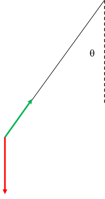

Words and images only!  In Prime, gifs do not animate.
Fred_Kohlhepp_0-1682595802798.png  A pendulum is shown suspended at an angle from vertical. The red vector represents the force due to gravity--always vertical. The green vector represents the centripetal force from the pendulum arm--always radial.
Fred_Kohlhepp_1-1682595900248.png  The summation of those two accelerations (mass is the same) result in the tangential acceleration (blue vector)--always tangential.
