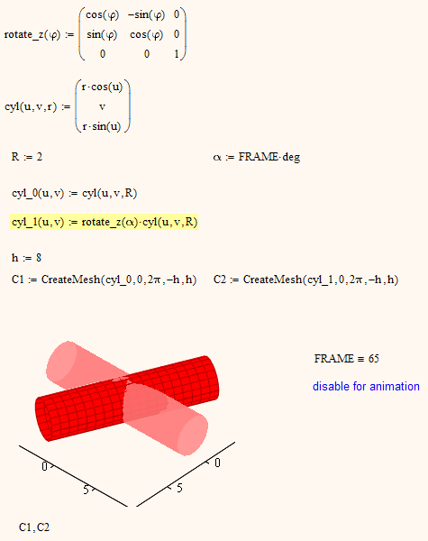

You wrote that you wanted to rotate around the x-axis, not the z-axis, didn't you?
The order of your multiplication is wrong. you can't multiply a 3x1 matrix with a 3x3 matrix.
You cannot evaluate the multiplication numerically (thats the reason you get the error message of u, v being unknown) but you must assign the result to another function in the two variables u and v.
Then you plot this function either directly in 3D, or, as I prefer for better control and convenience, using createmesh.

I am not quite sure what you are asking for.
To rotate you would simply apply/multiply with the appropriate transformation matrix.
If your cylinder is rotated around the z-axis its axis will still stay lying in pi1 (xy-plane).
Are you generally asking how to display a parametric surface in a 3D plot or is your goal an animation showing the rotating cylinder?
Thanks, that is exactly what I am trying to do.
How did you do it?
I have tried to use the previous matrix but with 3 columns instead of three rows and multiplying it by the following transformation matrix:
I suppose that the mistake should be something very simple. Sorry for that.
Thanks and regards,
Enrique

Hola Enrique.
Espero esto sea lo que preguntas.
Buena suerte.
