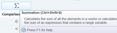

If they want you to press shift they'll say so, like the keyboard shortcut for Summation as opposed to the keyboard shortcut for Polar plots.

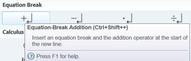

Compare to the equation break operator for addition.
They could express it as ctrl + = or ctrl + shift + = (or Summation as ctrl + shift + 4) but I guess they also want to express the keyboard shortcuts as intuitive where possible. (Where you associate the plus sign with addition or subscripts.)
