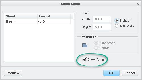

This might seem obvious, but make sure your drawing has the "show format" checkbox ticked. Double click the Size at the bottom left of your drawing.

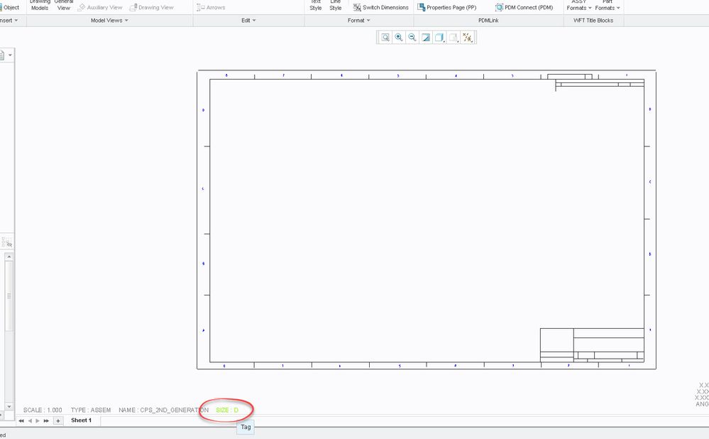

Sorry jstone-2, I think folks are totally missing my point. I know HOW to make a format and how to use it. I was just in a rush last week to make a completely new format for a new customer and didn't want to have to make one completely from scratch. (It needed to look completely different from the one I currently use) Since it has been years since I've even looked at a new format, I was hoping maybe PTC supplied a few good example formats that I could just tweak for my use. Obviously the only thing they supply is the sketched format you have shown with no tables or any default intelligence built in. I managed to grab one from GrabCAD.com that was close to what I needed and modified that.
