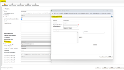

I should probably mention that I had tried this and was the first thing I tried, but for some reason the 'find' button inside of a edit user and the organization entry is greyed out. Do you know why that is? Or how to get around that and still add someone to an organization?
most likely lack of permissions, can you enable logger wt.access.evaluation.report to debug, try edit user and share the logs and user Name .
How do I enable 'wt.access.evaluation.report' ?
