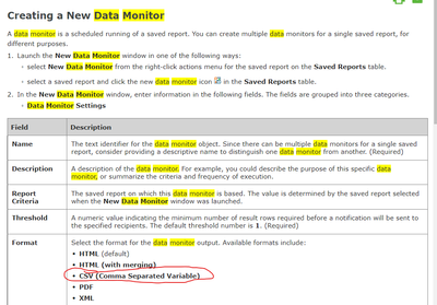

CSV attachement in Data Monitor Email
AK_9771363
Is it possible to get the result exported in the form of attachment as CSV to the email notification sent by ”Data Monitor“ in Windchill

But it is not an attachment. It is a link to the windchill to where csv gets downloaded.can we send it as attachment in the email.

Oh - I see.  No you can't do that with a Data Monitor.  It's not part of Windchill functionality.
Will it be possible by Jasper reporting or with any other way.

I am not experienced with Jasper, but from what I understand it only extends the output from Query Builder type reports such as allowing for additional formatting and pagination.   I don't believe there's an OOTB way to do what you are looking to do, however it could be possible by using some type of REST or other Web call via PowerAutomate or something to download the file to a SharePoint and then email it out from there....
Why do you need to send the attachment? Why doesn't the link suffice?
