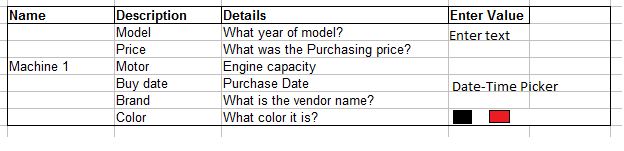

Can we use CheckBox,Textbox and Date-time picker in the rows of Data grid? if yes,how?
Making grid Editable will give you an option like Textbox ONLY. How about other widgets?

Hi Carles, Repeater can be used for repeated values row/column wise but it's not that case in my requirement.I have something like below.
I need to Enter "Text", Select "Date" and select "CheckBox" in same grid.
Now,tell me what could be the best way to achieve it.

Why not with the repeater? you can set a row mashup which as the columns you want with the desired widgets ( Text, Date and checkbox ).
