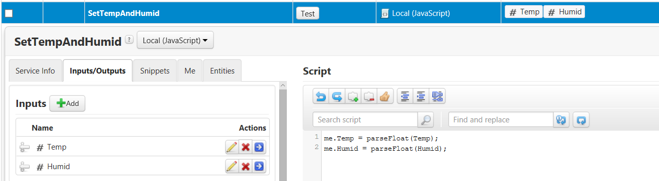

I have tried for many hours to send data from the Arduino with HDC1008-Sensor (Temperature, Humidity) but at last i dont get any further. I tried to adjust the Weather App with Arduino Uno Project. The Thing is a Generic Thing and the properties (Temp, Humid) are from type Number.
I have created one Service:
The adjusted Code for the Arduino:

Because of the "Unable To Convert From Java.lang.String to NUMBER"-Advice I changed the Base-Type of the Properties to String, but the message was still the same.
Next I added to the Service "parseFloat", but there is still the same Problem.

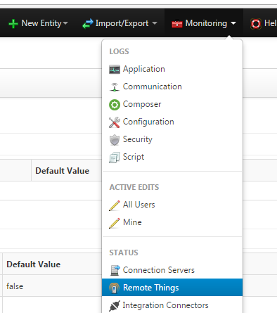

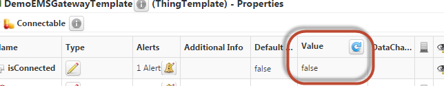

Marius, first thing would be to check for the Thing's (from which you have shared the screenshot above) isConnected property once connected you'll see following highlighted value changed to true
Otherwise you can also navigate to the \\ThingworxStorage\logs and check for the applicationlog.log  the other option would be to check from the ThingWorx > Composer > Monitoring > RemoteThings

I have a "Generic Thing" (described in the Tutorial) so I do not have the isConected Property and can not see the Thing in Monitoring->Remote Things.

When connecting your VirtualThing (which is running via your Arduino) you'd need a corresponding Thing created out of RemoteThing Template in ThingWorx Composer which will have required properties to bind and get data from Arduino. So I think instead of creating a Thing with GenericThing Template you should create one which is of type RemoteThing template. With remote thing you can see the property whether or not it's connected.
However since you appear to be not using any ThingWorx EDGE SDK, and rather just attempting to send the data over you may not see isConnected property as true. But you will see values being updated once there's successful connection.
