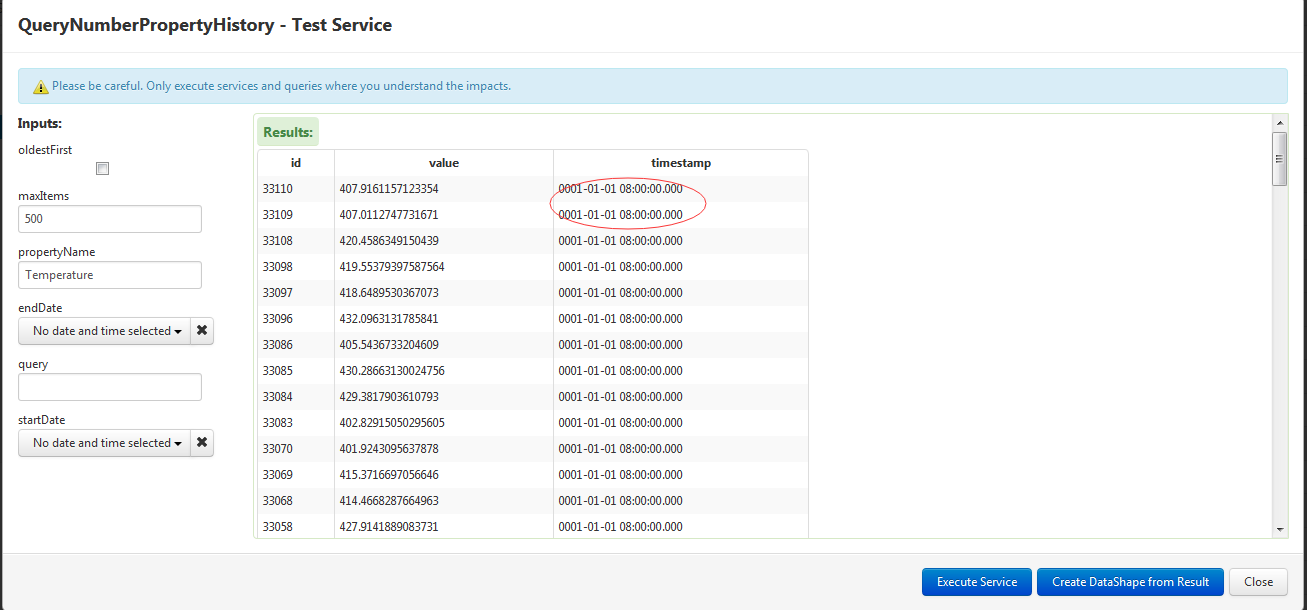

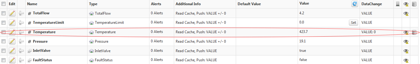

C # SDK record is a problem with the historical data of time?How to fix it?

Thingworx records the VTQ (Value Time Quality) that you are passing in from the Agent, you don't really need Quality, but you must make sure to not only assign Value, but to assign Time as well.
