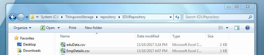

Please find attachments,

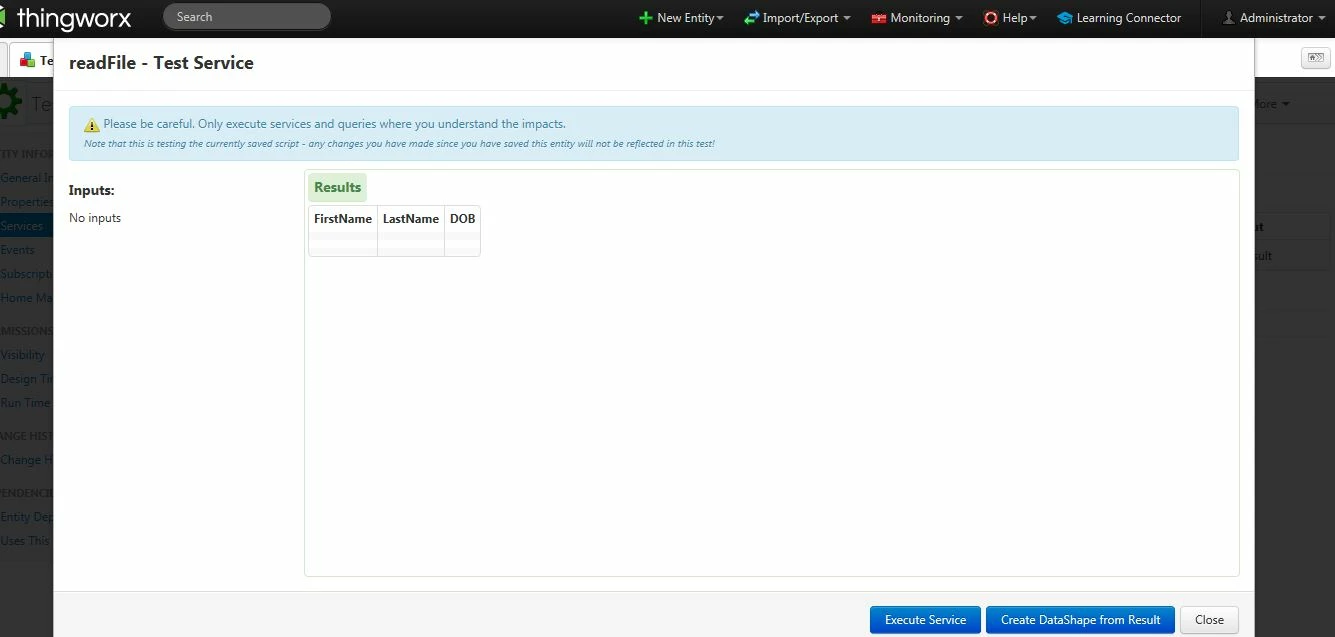

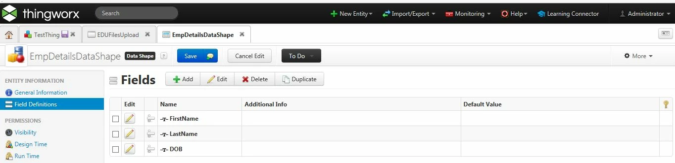

I am using ReadCSVFiles service of CSVParserFuntions for reading data from CSV files. CSV file contains 3 row of records actually (You can see in attached EmpDEtails.csv file).
but when I execute this service I didn't get any record as output but I got 3 empty rows. I don't understand why It's happening.
Please check script code below and let me know what I am missing so that I can fix it and get csv data and load it into grid.

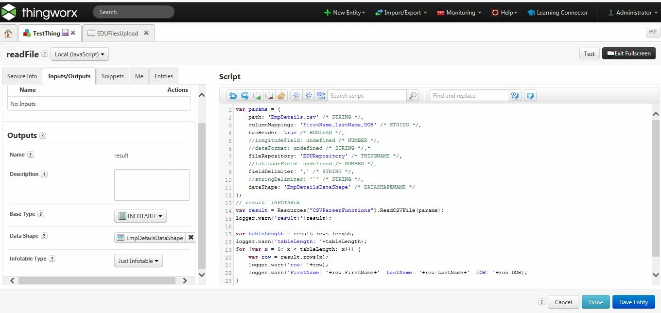

Script Code:
var params = {
    path: 'EmpDetails.csv' /* STRING */,
columnMappings: 'FirstName,LastName,DOB' /* STRING */,
    hasHeader: true /* BOOLEAN */,
//longitudeField: undefined /* NUMBER */,
//dateFormat: undefined /* STRING */,*
fileRepository: 'EDURepository' /* THINGNAME */,
//latitudeField: undefined /* NUMBER */,
fieldDelimiter: ',' /* STRING */,
//stringDelimiter: '¨' /* STRING */,
dataShape: 'EmpDetailsDataShape' /* DATASHAPENAME */
// result: INFOTABLE
var result = Resources["CSVParserFunctions"].ReadCSVFile(params);
logger.warn('result:'+result);
var tableLength = result.rows.length;
logger.warn('tableLength: '+tableLength);
for (var x = 0; x < tableLength; x++) {
var row = result.rows;
    logger.warn('row: '+row);
logger.warn('FirstName: '+row.FirstName+'  LastName: '+row.LastName+'  DOB: '+row.DOB);
Please do the needful asap.

Hi Rohit,
Some things:
  • columnMappings --> Separator it's ";" instead of ","
  • stringDelimiter --> It's mandatory, by default "\"", I mean csv content should have stringDelimiter for each value
  • If you are using an old version of the CSV extension then you need a line feed at the end of the file
Your code should like:
