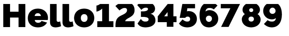

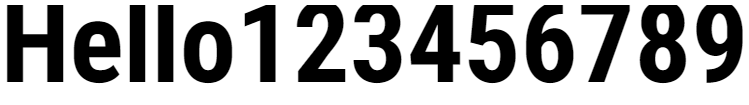

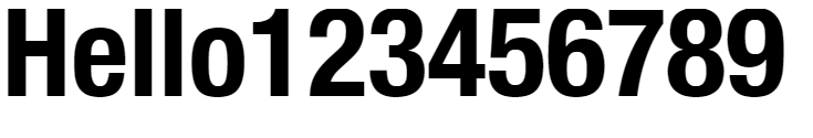

When I use fonts like RaleWay, RawWay, Roboto, and even Helvetica, the numbers and letters are cut off at the top.  This is especially apparent at larger font sizes:

Another thing I've noticed is when I enter the text in the Mashup Composer, the text is visibly above the upper border of the widget.
Steps to reproduce:
Upload ttf file to media entity
Use a Font Label widget and designate the ttf font media entity as the source url
Select a Style Definition that specifies a large (72 pt) font
Type text, save, and view Mashup
