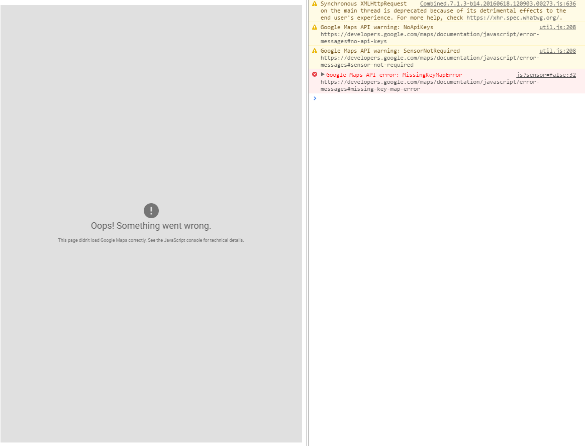

I used several times Google Maps widget, but in a recent ThingWorx installation on MS Azure cloud, I had the following issue when the Mashup is loaded.
Obviously, the Google Maps ThingWorx extension was correctly imported in my ThingWorx 7.1.3 environment.
Does anyone have an idea about how to solve it?

July 8, 2016
Hi Davide,
For production environment you should put your Google Maps API Key on the extension.
To do this, apart of registering on Google API services, you should decompress the extension and modify the extension as described on TW Google Widgets documentation: Google Widgets

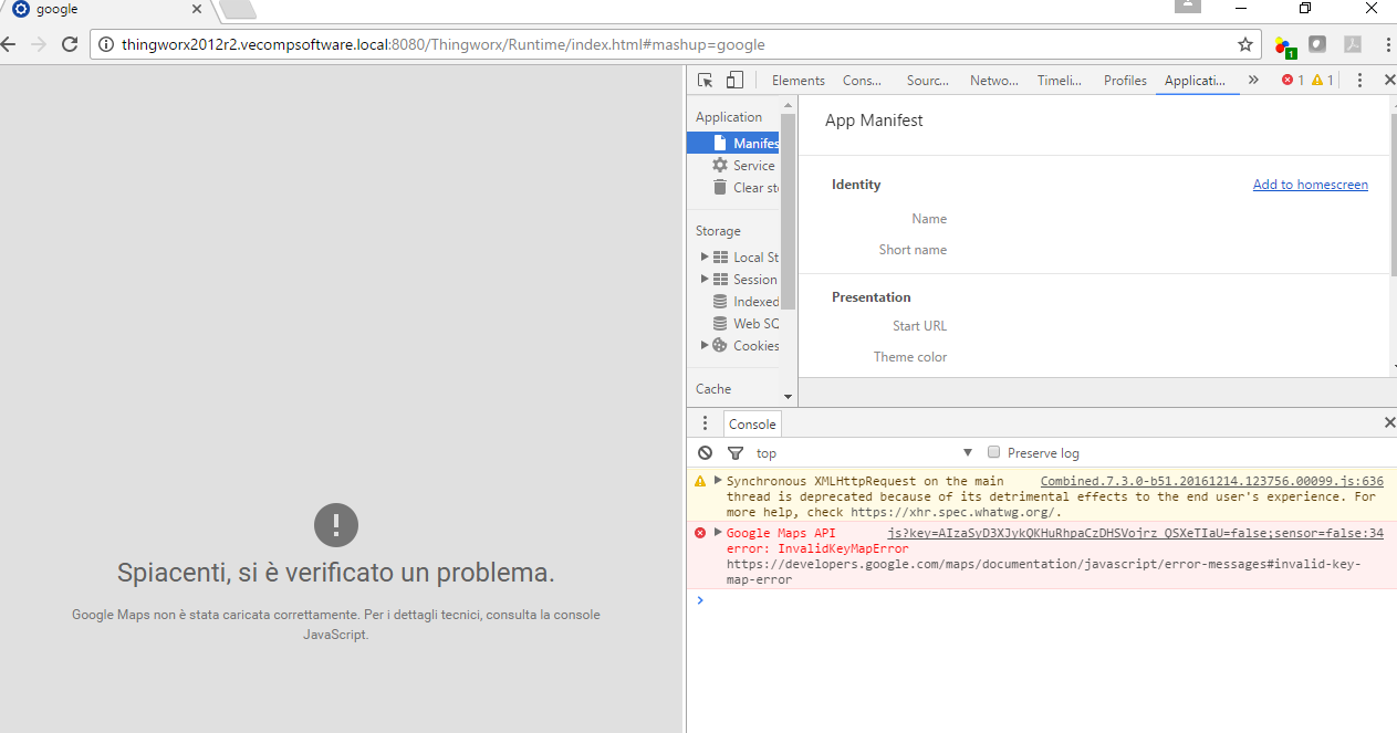

January 16, 2017
Hello Everyone!
My Google Map's problem is InvalidKeyMapError.
as suggested by some of you, i have inserted the key in the extension's metadata file.
I restarted tomcat and reistalled the extension several times but continues to say that the key is not valid.
Can anyone help me??
Thank's a lot!!

April 4, 2017
Nikhil Jain​,
What's the error in Browser console?
Ankit Gupta
April 4, 2017
Error I am getting is MissingKeyMapError

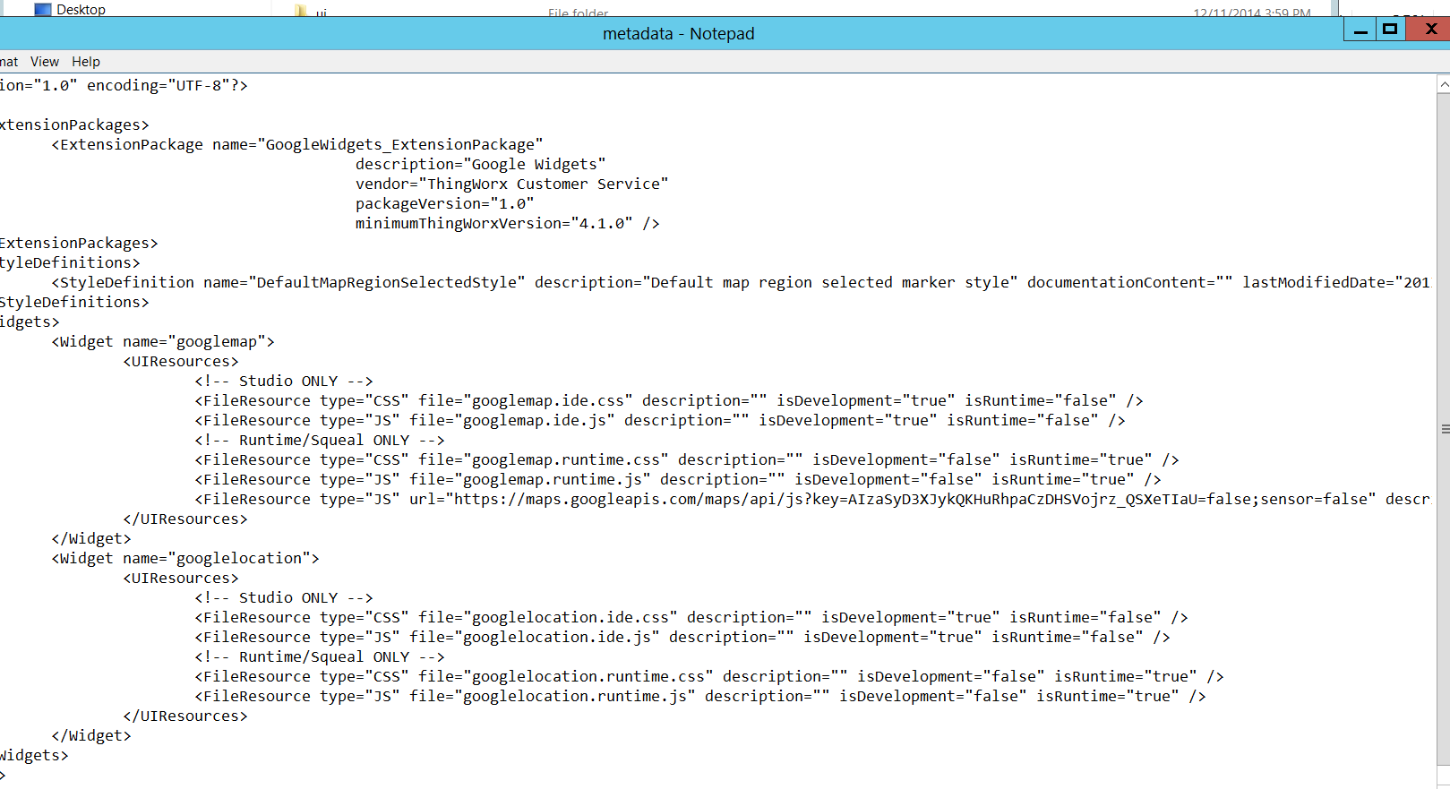

April 12, 2017
I had the same problem. I ended up hand modifying index.html from his location: Tomcat 8.0\webapps\Thingworx\Runtime
I don't think the extension import is working. My guess is that the metadata.xml file is supposed impact the "managed" area of this file. It's not doing it on my system so I changed it myself.
    <!-- *** MANAGED SECTION DO NOT EDIT *** -->
    <!-- BEGIN_EXTENSION_SCRIPTS -->
  <script type="text/javascript"  charset="UTF-8" src="https://maps.google.com/maps/api/js?key=YOUR_KEY"></script>
  <script type="text/javascript"  charset="UTF-8" src="/Thingworx/Common/jquery/jquery.jsPlumb.min.js"></script>
    <!-- END_EXTENSION_SCRIPTS -->
I left off the "sensor" argument based upon google's direction.
April 17, 2017
Intente todas las opciones pero solo me funciono lo siguiente:
url="https://maps.google.com/maps/api/js?key=MY API KEY" description="" isDevelopment="false" isRuntime="true" />
eliminando el parámetro sensor ya que no es obligatorio.
Lo edite en el archivo metadata.xml de la extensión de google maps.
