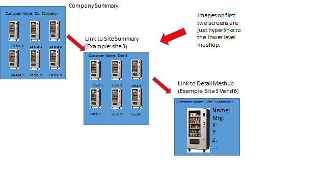

I have an immediate need to understand and get some guidance on the mechanics of how to design and execute a linked mashup drilldown such as pictured here. This is a classic cascading set of web page links each containing hyperlinks until user finally arrives at a detail screen.  Also need lateral and reverse navigation... but first things first.
I have looked at Trees, D3Tree extension, networks, and security organizations but not yet arrived at a clear and cohesive design or methodology that works.
Surely this has been tackled before using ThingWorx – yes?
Anybody done the same or similar and can point me to documentation, examples, or a framework in which to work?

It is basically 1) All vending machine locations for a company --> Click a site --> 2) All vending machines for that particular site --> Click a vending machine --> 3) the details of that particular vending machine.  At point 3 I have "drilled down" to the specific machine at a specific site for a specific customer.
Let me know what else I can share to explain.

For example, if you are using a Contained Mashup, you could store the value from the primary mashup (the vending machine locations) in a Mashup Parameter, and pass that into the name field of the Contained Mashup (assuming that that is the Mashup name). Now that you are at point 2, you could use the same method to get to point 3, or maybe use a Navigation widget instead and display a pop up for point 3.
