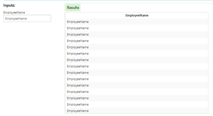

In my scenario I need to pass column name from mashup and want to display only that column data in grid.

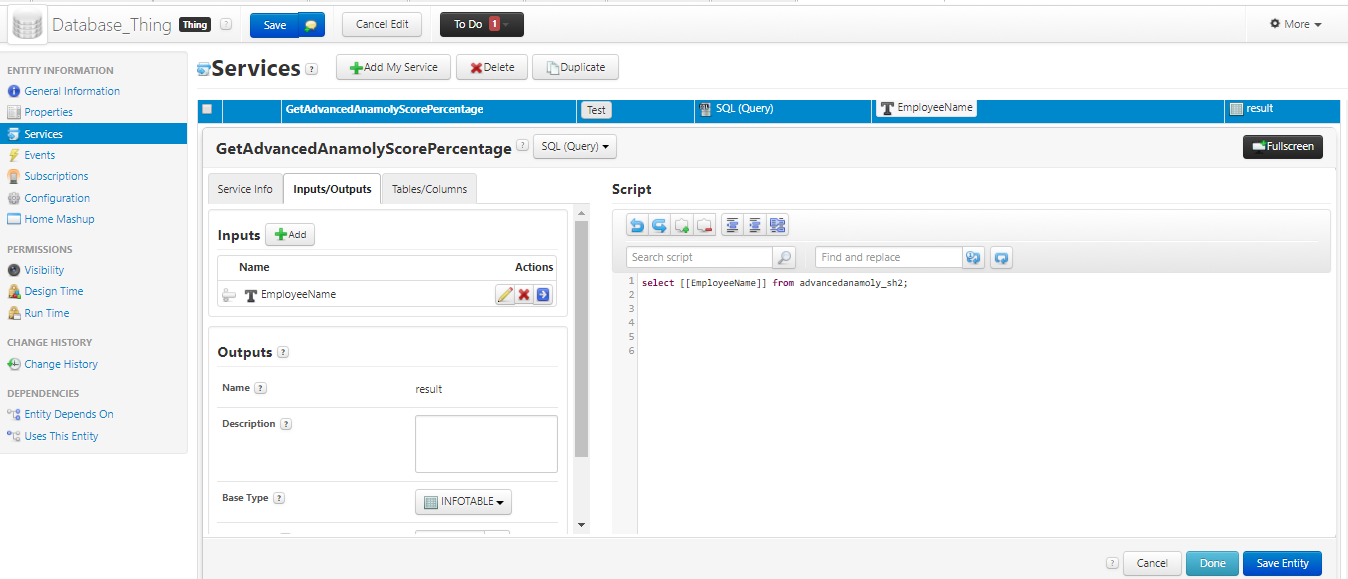

PS : I have created a database thing which has a service that takes input as column name and fetch that column data .
When I pass parameter as shown in the image its returning the parameter name in place of data of the column.
Can anyone help how to pass column name from input parameter.

Hello, Sudipta Jatta.
I found the article below which implies this is not a supported function of SQL Query.
https://www.ptc.com/en/support/article?n=CS237638
Unless I am misunderstanding your use case.
-- Craig A.
November 22, 2017
sudipta jatta​: Please replace [] with << >> to make query as below :
select <<EmployeeName>> from advancedanamoly_sh2;
Please be careful with the usage in query since it might opens up security risk with SQL injections at run time.
