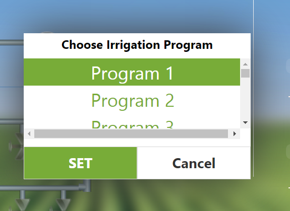

I have a list with data which is shorter then the width, Despite it it shows the horizontal scrolling.
How can I remove it?
January 25, 2017
I do not see a horizontal scroll bar appear automatically on mine, even if the display field is longer than the size of the list. What version of ThingWorx is this?
aelgov1-VisitorAuthor
January 25, 2017
ThingWorx 6.6.9-b12
January 25, 2017
Hi Assaf,
Please be aware, that the data should be a few pixels shorter than the container to assure, that there is no scrollbar.
