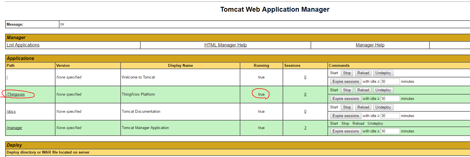

Hi everybody.
Today I installed:
1. jre1.8.0_40
2. Apache-tomcar-8.5.11
3. Postgresql_9.4
Than i copied Thingworx.war (Thingworx 7.2) to Tomcat directory /Tomcat/webapps
When i launch Tomcat (in google chrome), it is running correctly. You can see it on the picture.

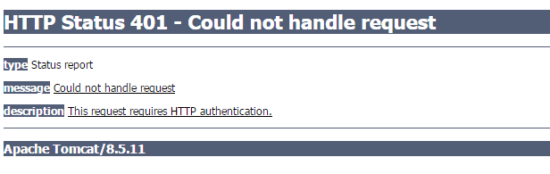

But when i want to launch Thingworx composer
(trying both just click to /Thingworx, or open new tab and type adress localhost/Thingworx) the issuu is occurred (picture below)
I follow every step by Installation quide for THingworx 7.2
Maybe you had or have had same issue.
Do you have any suggestions?

A couple of things:
1. Tomcat 8.5.x is not supported, instead please look into installing 8.0.33 or later minor version of 8.0.x
2. How did you deploy Thingworx.war? Through the web tomcat manager? If yes, then instead you need to stop tomcat, go to its folder tomcat/webapps on your harddrive, remove the existing Thingworx.war and Thingworx folder that are now in there, remove ThingworxStorage and ThingworxBackupStorage from your harddrive, go back to the tomcat/webapps and now copy Thingworx.war in there. Then start the tomcat and it will deploy/extract the .war. Try accessing the composer then.
In addition, please see this article Frequently Seen Errors upon launching the Thingworx application: and check that the database is connected (through pg admin, you would go inside the thingworx db, right click and ensure it's "connected", then also expand the tablespaces and ensure around 48+ were created). One more thing to confirm is the proper authentication credentials in the platform-settings.json file.
Hope this helps!
February 23, 2017
Hi Michal, in addition to what Polina already mentioned, could you please state which DB is used together with ThingWorx, if it's not H2 or Neo could you confirm if the schema is correctly setup and DB is reachable? ThingWorx.war failed to deploy for your because it couldn't connect to the DB saw this in your stdout log:
*** CRITICAL ERROR ON STARTUP: Unable to initialize and start system: Connections could not be acquired from the underlying database!

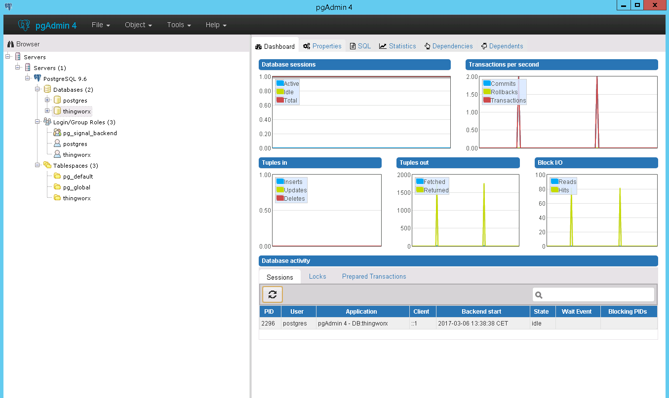

mhucik1-VisitorAuthor
March 6, 2017
Here you can see printscreen of my DB
