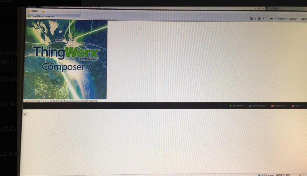

Hi all,
I meet an oops today. I open IE browser(IE 8, Win 7) to see the ThingWorx Composer, but it just shows me this. Then I use the Chrome, it is good. But some time later, "Oops! no memory." Do you meet these problems?
Thanks a lot.
The IE browser:
Bests.
Yijun

Hi Yijun, this issue could be related to incorrect/partial tomcat configuration we are discussing under your separate thread Could not load **Master", Reason 500, Could not create a transaction to Thingworx Persistance provider

HI, I update the IE8 to IE 11, it looks good. But I meet a new problem. Error occurred while validating HTTP header: referer . The more detail shows in
September 12, 2017
Hi Yijun, have you already tried backing up and removing the validation.properties file from the location \\ThingworxStorage\esapi and then restart Tomcat it will generate new validation.properties file. Is your Tomcat setup with UTF-8? Make sure that Java option for your Tomcat has -Dfile.encoding=UTF-8
