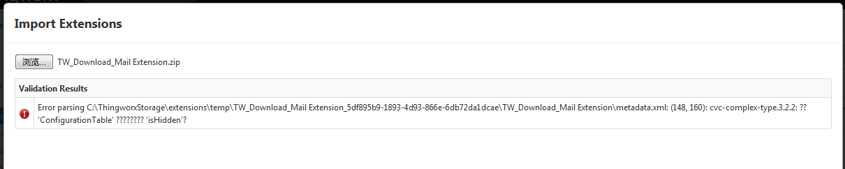

October 19, 2017
I tried to import new mail server version, but it fails. it shows error as:
We are using TW version 7.3.1. like as  "MED-61032-CD-073_SP1_ThingWorx-Platform-Neo-7-3-1" .What could be the issue here?
Error parsing C:\ThingworxStorage\extensions\temp\TW_Download_Mail Extension_5df895b9-1893-4d93-866e-6db72da1dcae\TW_Download_Mail Extension\metadata.xml: (148, 160): cvc-complex-type.3.2.2: ?? 'ConfigurationTable' ???????? 'isHidden'?
