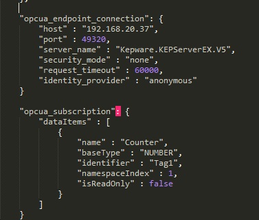

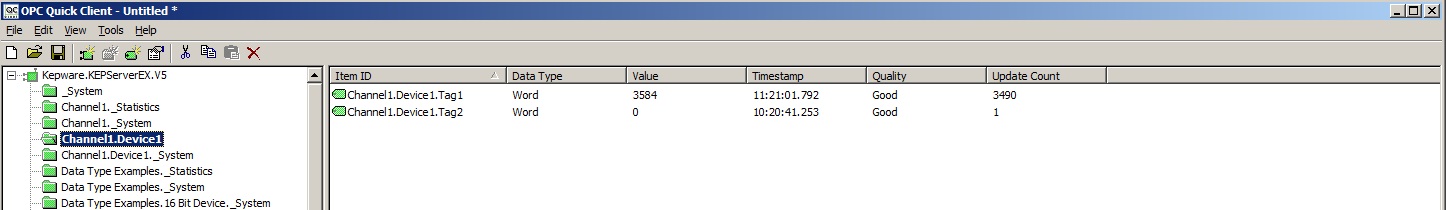

I'm trying to connect to an OPC Server simulator with OPC UA protocol. I've downloaded from the marketplace the extension, followed the guide but from thingworx composer i can't read my property "Counter" but i can see it trought the menu manage bindings. from the log of microserver seems to be all ok, i have remote thing connected but i have the property "ConnectedToOPCUAEndpoint" set to false. I'm using the Kepware OPC Server simulator and with another OPC Ua client it works, so the server is ok, i set up no security for connection.
Maybe is fault of namespaceIndex (Channel1 has index 1)? i think it is 1 right ?

@Alberto: Did you try changing the baseType to INTEGER? In ThingWorx the NUMBER baseType is used for floating point numbers. Based on the name "Counter" I guess this Tag1 is an integer type.

Yes i've tried to change the base type to integer but nothng changed.

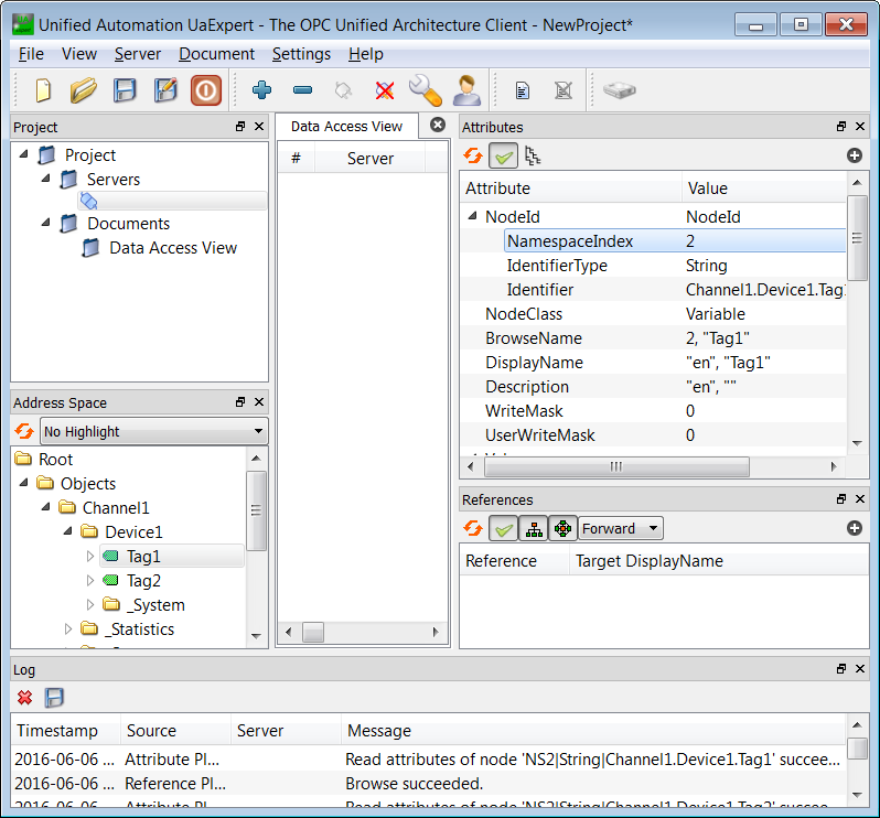

Hi Alberto, I finally figured out why I could not read the Tag values, maybe the problem is the same for you too.
The main problem was that the namespaceIndex was not correct, I used the following configuration for the opcua_subscription:
"opcua_subscription": {
    "dataItems" : [
         "name" : "Counter1",
         "baseType" : "INTEGER",
         "identifier" : "Channel1.Device1.Tag1",
         "namespaceIndex" : 2,
         "isReadOnly" : false
The identifier needs to be the complete path of the tag for example: "Channel1.Device1.Tag1" and the namespace index in my case was 2 (it is probably the same for you as well)
You can check for the correct namespaceIndex using the UAExpert tool. It can be downloaded from the following link: OPC UA Clients - Unified Automation
I hope this will be helpful.
