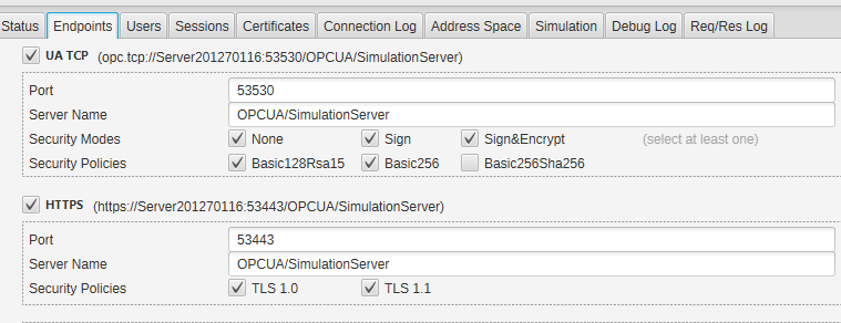

Im trying to connect ProSys simulation server to Thingworx. Looks like the endpoint connection cannot be established, below are the steps i followed,
1. Downloaded OPC - UA extension from Market place and imported to ThingWorx. .
2. Copied the config and jar filto C:\OPC
3. Created an app-key for administrator and altered the Config file with the app key.

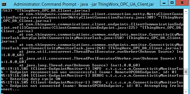

4. From cmd prompt (As administrator) ran the jar file . Endpoint connection cannot be done.
Prosys simulation server in installed in the same PC and Firewall is open for all ports.

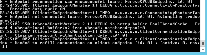

Endpoint Error :

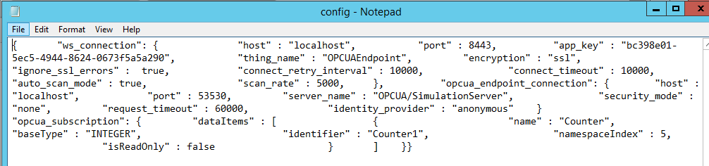

Config file :
Remote thing under Monitoring :

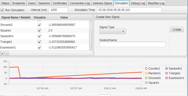

Prosys simulation server :

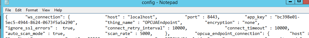

Dinesh, does this happen only over ssl or is it for http as well?
August 3, 2016
Hello Aanjan,
It is happening over http as well. Any idea on what i'm missing ?. I'm using ThingWorx composer 7.0

Dinesh, can you change the port to your http port? Instead of 8443, you would need to hit 80 (or 8080). Can you post the config and the entire log file in text format as well?
August 10, 2016
Aanjan, Using the 8080 doesn't help. There is no trace of log in ThingWorx. attached the config file.
