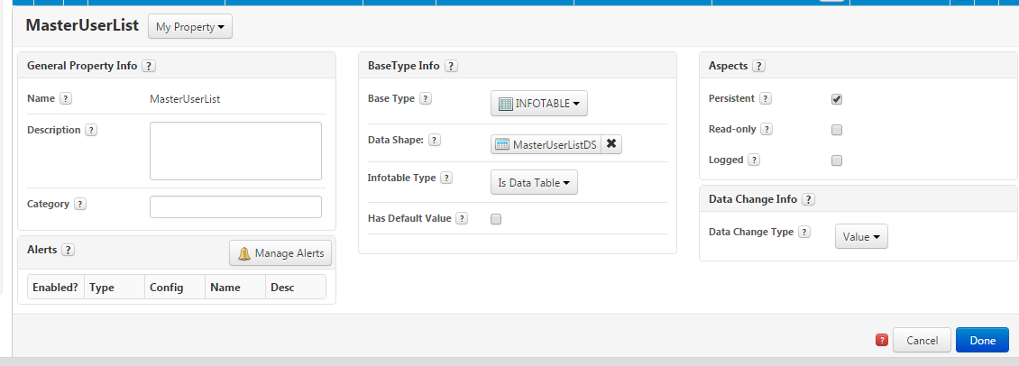

I have an infotable that I set to be of type DataTable and I made it persistent. Despite this it gets emptied when the server is restarted.
It doesn't have a default value assigned to it.
I was expecting the data from it to be stored across server restarts.  Is this behavior normal or is some sort of bug ?

    Veronica, is this a neo install?
    vmihai1-VisitorAuthor
    April 21, 2016
    Hi Aanjan,
    This happens on a ThingWorx 6.6 with H2 and also  a ThingWorx 7.0 with Postgress.
    It doesn't happen on a ThingWorx 5.4 with Neo... with the same entities. I have imported them in the exact form.
    Thank you,
    Veronica
    April 21, 2016
    I've seen this happen with neo; especially when data locks or thread locks happen. The change would commit to memory, but won't commit to disk. With a Tomcat restart, they essentially get wiped out as they don't get written to disk. I'll test this out on 7.0 postgres.

    Hi Richard / Aanjan,
    Make sure to set it explicitely when modifying an Infotable Property. What does it means?
    When modifying a Infotable Property never ever do:
    me.myInfotableProperty.AddRow(whatever);
    me.myInfotableProperty.Delete(whatever);
    me.myInfotableProperty.rows.value = whatever;
    me.myInfotableProperty."WhateverModifierAction"
    Always ( repeat with me this mantra and burn in fire on your mind 😞
    1. Clone Infotable Property
    2. Modify the Cloned Infotable Property Variable
    3. Set the Infotable Property with the Cloned Instance
    Sample:
    var tempInfotable = Resources["InfoTableFunctions"].Clone({ t1: me.myInfotableProperty }); // -- 1
    tempInfotable.AddRow(whatever); // -- 2 ( or any other kind of modification on the Infotable
    me.myInfotableProperty = tempInfotable; // -- 3

    January 20, 2017
    Hi Richard,
    Yes it's the official way, at least for Persistent Infotable Properties, for non persistent you can go and modify directly the property.
    Yes it's inefficient, and yes you can have concurrency problems..., but anyway you are not dealing with a Database rows here it's just a property of type infotable which it's persisted ( I think ) as a JSON object no real tables are here.
    Carles.
