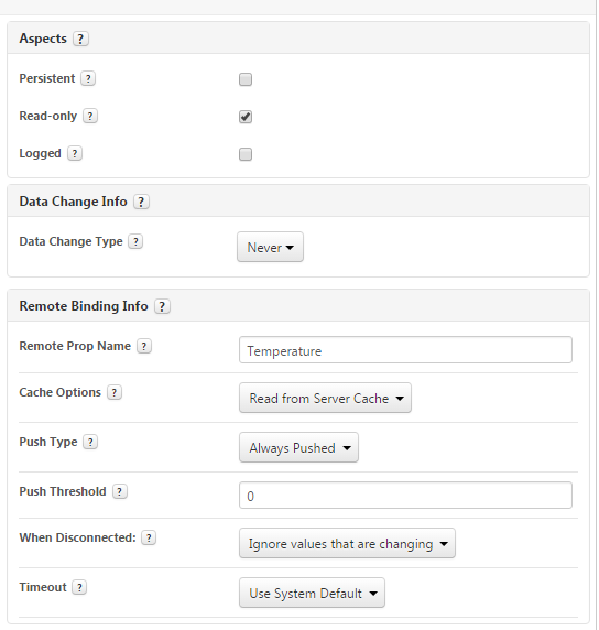

Here are the attributes in composer:
If i change the cacheTime to a positive value like 1, then it picks up the values from the cache.
Seems that you have to set a cacheTime value > 0 to see values refresh. I believe this means that if the value in the cache has expired, it will fetch from the Virtual Thing. This is not the behavior i want. I only want the values read from the cache.

cacheTime — Tells the ThingWorx server how to behave when reading a remote property. This parameter can take the following values:
-1 — Indicates that the VirtualThing always sends its value, and the server should never request it from the remote application.  The value returned always comes from the in-memory cache of the server. Use this value for properties that are configured to be pushed to the server.
0 — Indicates that every time the server uses the value, it should request it from the VirtualThing.
Any other positive value — Indicates that the server should cache the value for that many seconds and then retrieve it from the VirtualThing only after that time expires.
This setting is important for properties that may be accessed frequently by many users. For example, if 100 users attempt to access a property value within a 10 second period, you may want to set this value to 30 seconds.  That would ensure that only a single request for the property is sent to the edge every 30 seconds. However, the value returned by the platform could be out of date by up to 30 seconds.
Please share your thoughts as I think  behavior, you are witnessing from Thingworx is Normal .
